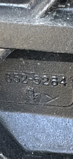

I noticed the block has an “X” stamped just under the part number on the block, but can only really seem to find reference to the J blocks online. Is there anywhere that has reference to these letter stamps? Wondering what the X stands for and what others there are?

Pull a transer port cover as that block casting is used on the non ported 115
