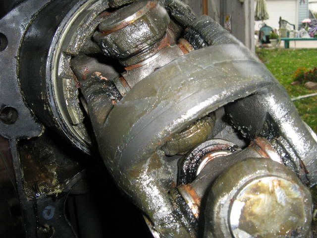

that's what i'm up to. i got the rustys on the ujoints..... i think i should have a look at the seal and brgs i guess. stop me if i'm wrong. i'd just soon not go that far. but understand it to be the correct thing to do for what i'm looking at in the pic. i've not got any parts yet as i don't know what i need to get yet. right now i'm stopped because i think i need to remove that brg retainer to get to the back u-joint. i do have a inch pound torque wrench. though it only goes down to 10 inch pounds....click type. hopeing to get away with clickin down to under 10 and hope its accurate.....w/o looking at the bible. seem like i remember reading needing aound 6....

looking at that picture? yep dissasembly is gonna be required for yoke inspection and seal replacement.
depending on the unit you will either tighten the NEW pinion nutand NEW tension washer to a rolling torque,need a dial inch pound wrench, or a specific torque.
looking at the corrosion in the shift slide pocket you need to inspect the shift cable and the upper shift shaft seal very carefully.
if its not been done before it is possible to reposition a new seal in the bearing carrier. cut a shim sligtly smaller than the seal od, place it inside the carrier bore, press the new seal into the seal carrier. this will insure the seal is square in the carrier bore and move it back about .045" to.060". this can be done once without any interference issues and save ya about 90 dollars or so.

the way i'm reading it in service manual #2 is for reassembly is to place the washer concave side faceing the drive gear then the nut. being sure that the preload spacer is centered and don't proturde past the brg. cups. then torque to 85 ft lbs while turning brgs.
yes, that's where most of the rust seemed to start at. the shift shaft, shift shaft lever, shift shaft upper seal (used the new style double seal) shift cable and bellows were replaced. gimble brg. replaced. main bellows replaced. and the nasty a** waterhose too....
interesting idea. this is the oil seal pressed into the oil seal carrier yer talking about?
hopeing i've caught this soon enough to not have horrible rust damage. gear oil looked ok at end of season, no metal particals i could tell. was a little foamy but by next morn the foam looked like highperformance gear lub only.

Its the upper seal/yoke. the upper doesn't see much oil as it is and when the drive is run down on lube it is the first to go. what happens is the seal wears a groove in the yoke and the machined surface on the yoke will no longer provide a sealing surface.
If you shim the seal out a couple thou you are pushing the seal up unto the uneffected (and hopefully still good) part of the machined surface of the yoke.
If your doing the job for somebody else, don't mess around and replace the yoke. if your doing the job for yourself, it can be done but you'll want to pressure test the drive afterwards. (which should always be done)
if you don't pressure test it... then the yoke's on you!
