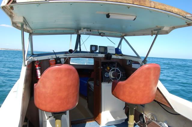

Perth, WA.
Engine and leg are in fine fettle.
The ride of this boat is just awsome, the deep Vee hull cuts through the chop/waves like a sharp knife!
Looks like the altenator can be rebuild (propper marinised oe) after speaking to the actual owner.
Have replaced the old foam inside the engine cover with good fire retardent aluminium backed insulation.
Slowly getting it ship shape.

Hi Guys:
What a good looking boat!
