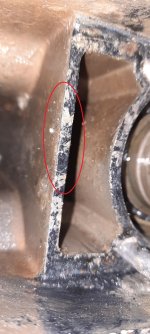

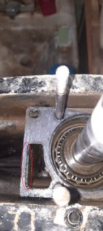

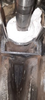

EUREKA! Found the problem. Gasket under pump was allowing air from the exhaust chamber to be sucked into the pump. Look at the pictures. The mating surface was irregular and the gasket was not properly made/fitted. The two conditions allowed exhaust gases into the pump. Cleaned and trued up the surface and installed new, better fitting gasket and no more cooling issues.

dubs283
Jul 27, 2005
5,346
"Did you replace the separately purchased water pump base/seal housing and gasket?"
Yes. All new.
Recent pics show fairly deteriorated gasket
You removed the newly installed base and gasket to discover this?
johnkom
Jul 26, 2004
181
Yes. That is the gasket under the water pump base. I had an air leak at that drive shaft seal two seasons ago. So I replaced the entire pump including base and all new gaskets. That is why I was so late to check that area for a cooling problem as I had just been in there. I did not notice the poor fit for the gasket. It was only touching about half of that mating surface. Attached is a picture of the seal air leak blowing bubbles.
Ahh good catch. This is why the clear hose test is so important.
Two seasons does not equate to recently replaced
Merc recommends full water pump replacement every 2-3 seasons

Really!?! Water pump base and gasket replaced January 2021. I had a whopping ten hours on that pump base. It was bad from day one. Had nothing to do with seasonal interval.
Yep, really. 20 months covering two seasons. Doesn't matter how many run hours you have, in fact many believe not using the product causes premature failure.
Looking again at the recent pics it also appears no gasket sealer was used on the base gasket which is oem protocol.
Nothing you have stated or task performed is out of the ordinary. Your experience is a well known issue among mc-1 and alpha/r/mr drives.
Maybe you did receive a faulty gasket/base assy but based on info provided I'd say most likely the issue arose from a lack of gasket sealer upon install and time between replacement and failure, ymmv
