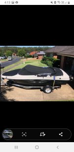

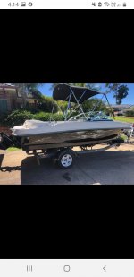

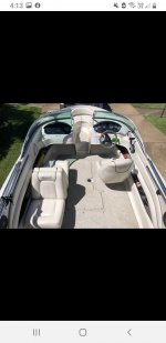

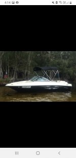

I am looking at purchasing a 2008 Searay sport 175 with a Mercruiser 3.0 (Alpha 1 leg). I've read some positive posts about this motor as they're economical with enough performace to cruise at 75kmh no problem. However I am a little sceptical as this is my first inboard. Some say as long as they're maintained and serviced then there won't be an issue. Others say the manifolds need replacing often which is costly. Also the legs aren't that great? I am confused and don't know what to buy. I want something with good performance however economical and as less cost to maintain as possible. Who doesn't! Should I stick to looking for an outboard or is this motor going to serve me well? Thanks all

I should mention it has 257 hours. Intake manifold replaced at 200. Serviced at 240. Apparently serviced every year before summer and flushed regularly with fluids topped up every few runs. Is this enough to substain a healthy and reliable motor for myself if I were to purchase this boat?
