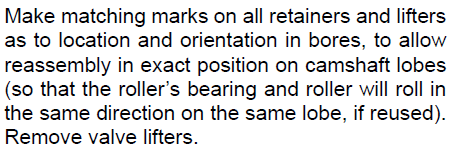

good day to everyone;
i'm rebuilding my 4.3 engine and i if possible i would like to recieve some info from expert people in the forum.
my original motor was a EFI 4.3 2001 due to some issue i had romoved that motor and now i'm overhauling and installing a 4.3 lx 4 barel (200 hp) and as said in other thread i'm saving and using some parts from my old 4.3 efi.
i brought all pcs in the mechanical shop for machining. i did: cilinder boor check and machining. new piston rings new bearing new cilinder planarity both head machined ecc ecc.
when i was in the shop i brought there both come shaft ( EFI and LX) and they said that EFI was better so they installed EFI one ( it should be same shaft)
now i have a doubt;
wich vlaves lifter should i use? LX or EFI?
i have 2 mai topics now, on manual i sow this 2 sentence
and
when i bought LX motor it was totally disassmebled so i don't know wich roller was going in wich cilinder, and especially direction.
and now that my camshaft is the one from EFI should i use EFI lifter accordinglly to last sentence or it doesn't really matter?
thanks

As SD nmentioned same roller. You can use rollers on any lobe used or new. The comment in the manual is for hydraulic flat tapped cams where the lifter wears in to a specific cam lobe
ste80
Jan 3, 2025
167
thanks, to both scott for the replay
what is confusing me is that in the manual the picture where they said this is for same roller that i have got see below
i was thinking the same about model and about fact that cilinder block is same but the sufix (1) on roller name and differenc in spare part price was confusing me. i was thinking that the difference is related to the fact that EFI is usint head with final number 113 and has roller roket arm ,

the marking the lifters is so you have them rolling in the same position you take them out
regarding the rocker arms, you are mixing and matching various generations.

As SD mentioned same roller. You can use rollers on any lobe used or new. The comment in the manual is for hydraulic flat tapped cams where the lifter wears into a specific cam lobe
that's what I thought as well, could it be they gave advice for the older style flat tappet but used the pic from the newer style roller lifter?
No those are rollers. In general pretty much have seen that rollers can be reused with different cam etc. my other hobby is a 65 GTO, guys reuse roller lifters with different cams all the time, it’s seen as an advantage going with a roller , which on a pontiac V8 is pricey. Buy a good set of roller lifters like Morell and you can swap cams down the road.
I recall seeing in Mercury remanufacturing video how they were testing and reusing cams and roller lifters. In reality getting a bucket of parts might not be worth the risk considering most Chevy parts are relatively cheap in boat and engine part terms
thanks. so you suggest to go for new lifters? i know that in USA the cost are relly heeper for this parts, the problem is that in itlay is not like there because we do not have many chevy car. tomorrow i can go to auto repair shop and check, but i don't think it will be easy also because they will ask for car sn or nameplate that i do not have :)
or otherwise between EFI and LX maybe i shuld keep lx (due to the difference of pn of the lifters 811844 vs 811844 1)

I'm thinking of all the possible mis-matches, if the rollers are not in the same cylinders, I don't think that will cause a problem with roller lifters.
i hope the same. lifter are all same, so it should be ok, i was wondered when i sow that rthings mentioned in the manual this is why i asked.

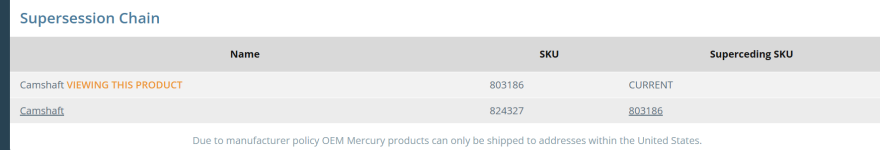

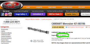

hi scott; i check your nice post about 4.3 model but can i ask you something that is making me confused?
my iron cast is 10227196
i was looking the part of cams; and i have some doubt now.
you said that in 95 there was the cams 10241693 and in 96-98 the cams 10241692
if i'm looking the mercruiser code for EFI and lx for example i can see that
lx is the number 824327 and EFI number 803186;
if i go online and i put those number it seems the same cams
or
or
from above picture it seems that 803186 replaced the 824327
when i was on the mechanical shop i brought both of them , saying to check if they were same and wich one was better. thy installed the efi one, but now i'm really worry after looking your thread if they are same.
pistons i do not have bigh doubts, also because before to bring there i checked the spamped number inside of the piston and i brought there all for check, and they machined cilinder accordingly to pistons size
for lifter i will use LX lifter if i will not find new one at this point i would be much more sure that they are ok and same for studs
what do you think?
or
or
what do you think?
Te later one replaces the earlier part number so it is the same. If you look up mercruiser lifter part numbers they are the same i think, one supersedes the other.
