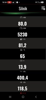

Small update to this "little story". I changed out the 14.5x19" SS sporty prop to the same size aluminum one and tested the boat. I decided to go with a stock Black Max 14.5x19" prop for this Bayliner VR5 setup. I
n another post, I mentioned having issues with the motor mounts and alignment. Finally, I managed to align the engine to the point where the alignment tool can be inserted, spun, and removed with just two fingers, and the grease patterns are even all around.
Today I eventually had some time, and the weather was great for a test run. With the new prop and the outdrive properly aligned, the engine revs up to 5240 RPM, hitting a top speed of 80 km/h (approx. 50 mph). The test was done with 2 people onboard and 1/3 of a tank of fuel. I noticed a better hole shot, and fuel consumption in the mid-RPM range (e.g., at 3000 RPM) dropped from 30 L/h (approx. 7.9 GPH) down to 24 L/h (approx. 6.3 GPH). It runs great and feels like a different boat.
I want to thank everyone for your help and replies, especially @muc – thanks for your patience. I remember that after ruling out engine issues, your last guess (probably first one as well) was a wrong prop and an issue with the outdrive or alignment. Turns out it was actually a mixture of all the above.Can't believe I was chasing my tail for a few weeks this summer. The only thing that was wrong with the engine was one O2 sensor that I replaced. 1000030329.jpg1000030325.jpg

The tool I used before the season showed that it was fine, but the guy I got it from had it machined, and the OD of part getting into the spline was too small. I got a new one, and when I first tried it, it went in only 0.5" before jamming and becoming impossible to remove.
The bad alignment and a bad prop caused that difference. I was very surprised by how much it was lugging the engine
