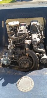

Got the kit from Breezeworks and installed it. Took the boat out yesterday. Was nice to have it charging the battery. Fairly simple to install and wire up.

Nice. Feels good to check something off the fix list. I just got my first boat this past spring. It's a 1989 3.7LX Mercruiser, so probably very similar--if not the same--as your stock charging setup. I too went with breezeworks and had no issues. Great kit!
If you wouldn't mind humoring my curiosity: how many volts are you at now while running? And does your dash still show a bit different than at the battery posts? Mine shows 14.6V at the battery all day, and 14.0 on the dash. Just asking for the sake of comparison.
