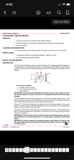

That has a knock sensor module is the sensor or module non functional and causing it to go into timing retard mode constantly? Unfortunately the nimrods at merc set this up to need like 9 v supply from knock module to the ignition module to keep it fro retarding timing.
Below is an except from the manual on how this works.
would -
see if it is supplying the 8-10 v the ignition module requires
if not supply verify it is not knocking looks for signs of detonation on plugs and piston tops . Possible you have a bad knock system retarding timing.
would be surprised if you have no advance over initial base timing that you would even be able to get to 4 k

i discounted that to see if anything would change. Nothing changed.
So it’s possible that i have a bad sensor or module. I’ll check voltage in the morning.

So went out today. 12 V to the knock sensor. Not sure what’s going to the ignition.
retimed, set carb
one of my valve covers had vacuum line going to the back of my carb. i though both go to the flame arrestor.
Moved that.
Idk what happened but at 2500 rpm i finally had a timing change. by about 20 degree. Find out tomorrow on the river.
retimed, set carb
Moved that.
Willing to bet your knock system is retarding . Its not the 12 v to knock module its the 8-10 v from knock module to ignition module that is what keeps it from pulling timing out. If yiu see it not advancing i would either get a inline resistor like in a older style points and supply 9 ish v to the igntion module on the knock sense wire.
