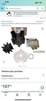

Alrighty…assuming this is the right kit, I’ll let you know how it goes.
Sorry nope that’s not the right one…you should have an Alpha stern drive and that impeller is for the engine mounted Bravo drive system unless you happen to have an engine mounted water pump which is usually on lower side of the Chances of having but not impossible either.
Yeah, it’s a bravo 3 stern drive and the pump is indeed under the engine. Couldn’t be easy..
Odd, your engine serial number 0M663009 suggests the engine Application is an Alpha stern drive so that is what was leading me to say most of the above Conversation… it all still holds the same just with a different location of items mentioned… These impellers are a bit more fragile vs the Alpha drives and should be changed out much more often…
You still need to use the muffs when running the engine …The up top was more meant to flush the engine while in the water and engine off.

FYI that style bravo pump has a plastic housing that should be replaced along with the impeller. Merc sells a kit with impeller, plate, housing, seal and hardware for the job. Only parts needed from the old pump are the lock washers and nuts to mount to the bracket
This is the one you’re talking about, right?
