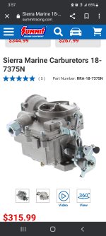

Okay, I checked the carb, there are no markings or numbers on it, but after doing some research I believe it's a Sierra carb(I thought Sierra was a decent brand, you think they would have some markings or something to identify it) Here is a picture of the carb I BELIEVE is on it. Not 100% sure though

Okay, I took the carb off to check the float height and it seems to be too high(causing the carb to flood). I was looking for the little ruler to measure the float height and found the old carb in the box that the new carb came in. Turns out the new carb is a Sierra 18-7375N. It says on the box it is for a Mercruiser 5.0, the engine in my boat is a 5.7. Could this be the issue? The mechanic insisted he had to order the carb to make sure it was the right one and this one says its for a 5.0, not a 5.7. So I did find out exactly what carb is on the boat now, but I cant find anything on what to set the float height at. I know what the Mercarb should be set to but I am not sure if its the same height as a Sierra. Does anyone know the float height for the Sierra 18-7375N? Any advice on whether or not the 5.0 carb will work with a 5.7. Its been running pretty good until the last few months so I know is was working good at first, but not sure if it will work in the long run. Thank you in advance for your help, I'm ready to be back on the water and I'm sure my daughter is too.

You need to kit that carb. Set the height same as the one for the 5.7. Replace the needle valve and seat cause it leaks. I would expect the 5.0 carb to be calibrated too lean for your 5.7. So get a peak at your plugs and see if they show signs of that. Post pics if you want.
