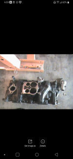

you may want to check the gauge. any reading greater than 150 is suspect or there is water or oil in the cylinder. a brand new engine from mercruiser or volvo penta or GM will have 150psi as cranking pressure
with a dual plane manifold, only doing one bank would also be suspect.
with a dual plane manifold on an SBC, one half the carb feeds cylinders 1, 4, 6, and 7, the other side feeds cylinders 2, 3, 5, and 8
only way to get one bank to be wet and fouled is to have a single plane manifold. then the lower of the two banks would flood.
you may want to check if its your exhaust leaking. that would wet and foul one bank vs the other.

I'm not very knowledgeable about intake manifolds. This what I have on the boat. The lower of the two sides is flooding... Cylinder side 1, 3, 5, 7.
Would the base gasket be a contributor... Its the thin open plenum gasket. Not the spread bore...4 holes...
Thanks for all your help
