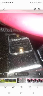

Good day to all. Can you please tell me if it is possible to replace the Mercruser block with a block from the car? I read that a block from a Chevrolet might fit. But I did not find specific information or missed it. After the winter and improper preservation of the engine, at the first start, in the spring, after 30 minutes, the engine stalled. At autopsy, an emulsion was found. When dismantled, it became clear that the block had cracked. I don’t have much time and money for a new unit from Mercruzer. Please advise, who can do what? Thanks everyone.Screenshot_20230602-182429_WhatsAppBusiness.jpg

Judging by the picture it is not the older GM / chevy 6.2 but rather the newer Merc made 6.2.
if that is accurate then you can only get parts through merc or a marine salvage yard used engine
i would call michigan motorz go over exactly what have they likely can get you set up with new and reman options

The engine in the pic is not a GM based motor, so a GM short block will not work.
The only choice is another Mercruiser 6.2

  • 6.2L (377 Cu In) V8 Mercury
  • 6.2 MPI 300 HP
  • [2A530776 & Up] - Cat.# 90-8M0124044
The cylinder block is listed as not stocked separately. There is a long block P/N . . . 8M0114814. Lists for about $11,000 USD

This is the mecury marine cast 6.2 not the older GM made 6.2. these newer marine specific engines were never used in cars or truck

  • Can you please tell me if it is possible to replace the Mercruiser block with a block from the car? No . . . For this engine, being the new Mercruiser in-house built casting and parts it is unique to Mercruiser and not made from an automotive block.
  • After the winter and improper preservation of the engine, at the first start, in the spring, after 30 minutes, the engine stalled. At autopsy, an emulsion was found. When dismantled, it became clear that the block had cracked. Yes - It looks like the crack went into the sidewall of the cylinder
  • I don’t have much time and money for a new unit from Mercruiser. There are not any inexpensive routes, since an automotive block is not compatible.
  • Please advise, who can do what? The best option - IMO would be to find a used Mercruiser engine in the 5.7 - 6.2 range and replace the entire engine. You could then try to sell the usable parts from the original engine to recover some of the cost.
