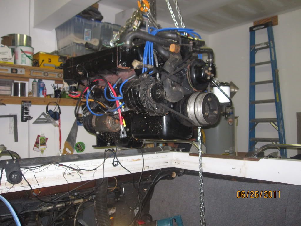

If anyone needs component pictures, or pictures that would help them with disassembly, please let me know. I want to give back to the forum and not just benefit to the wealth of knowledge here.
I took pictures of every part prior to disassembly.
Just tell me the photo you would like and I will post it
Pre-Alpha drive with associated bellhousing and gimble assemly
302 ford engine
Mercruiser 888
