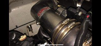

Hi..I am also a little confused about what is being asked...But got me thinking about a cat exhaust fitted on an engine identical to mine and only 7 years younger...where is the cat actually located in the exhaust and does it reduce her power at all ?
Also thought it a good excuse to show off my lovely, immaculate, near 20 year old mpi and her full Corsa Marine system...😊

QBhoy
Mar 10, 2016
8,348
here she is...one of her big side exits on show 😍
