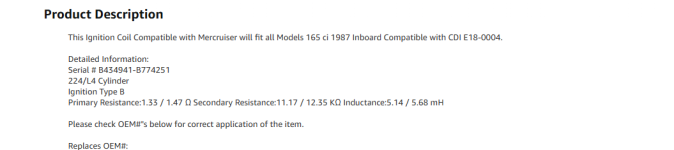

you can ohm test the coil to see if it is off spec attched is a snip from specs on an aftermarket coil for your engine Would assume yours should be close.
Also agree servicing the points and condenser is warranted, verify you have about 9 v to positive side of coil when key is in run as ballast resistor can fail. Can jumper around it briefly to test
