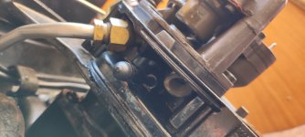

Got one spark plug off and noticed an unusual brown colour (please see attached pictures), so ordered a new set of plug wires and spark plugs, installed them and boom the engine fired up right away and was idling as it should. The response to the throttle was immediate but there was still unburnt fuel coming from the exhaust. It seems to me that both the injectors on the carb are spraying more fuel than needed and spark plugs get wet with unburnt fuel.

With the description above the more probable "sensor" (if actually the case) to cause these types of issues would be the MAP sensor...Item number 16, https://www.mercruiserparts.com/bam/subassembly/31880/2338/110
The other sensors mentioned above, not really so much (but still possible of course) with an exception of maybe the distributor module item number 9 only because of how the engine seems to not be running correctly, https://www.mercruiserparts.com/bam/subassembly/31880/2338/80
Or engine temperature sensor item number 17, https://www.mercruiserparts.com/bam/subassembly/31880/2338/70
Fuel psi from a bad regulator? yes it could be too but the fuel pressure should really be checked first so you know what the fuel psi is right now and then after a new regulator should you decide to buy and install one just because you've been running down this road already it seems.
Make sure the engine temperature is truly reaching 160 degrees and sensor # 17 sees it reading right on a marine scan tool...Not the dash gauge as it's a different sensor than the ECM sensor.
Also you may need to try connecting a vacuum gauge up to see what the inner engine is doing too.

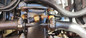

Bought and replaced the engine temperature sensor last weekend (picture 1), had already replaced the distributor sensor last year and finally bought the map sensor and will be replacing it also next week.
Engine started effortlessly, was idling perfect and the response to the throttle was immediate. I'm sure the rpm were certainly higher than what I used to hear up until now. Nevertheless black smoke was still coming out of the exhaust, maybe the exhaust is filled with smoke and will clean eventually, who knows? (picture 2 is taken while on idle). I can't tell if excess fuel is sprayed by the tbi as I have never seen another, took a video but I can't find a way of posting it here.

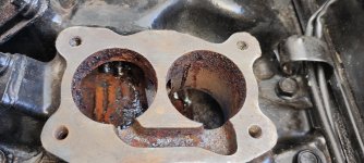

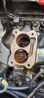

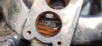

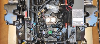

Took the throttle body and the adaptor assembly off to replace the gaskets and noticed rust marks inside the intake manifold, is this usual? Please take a look at the pictures...
Many thanks,
