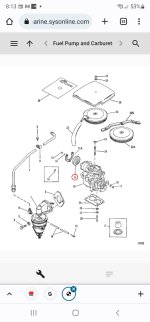

If you look under fuel pump and carburetor the electric choke is listed for the 90-94 3.0
alldodge
Mar 8, 2009
43,892
part #11 is electric choke element
Going to need to advise further
One of the parts listed is a Sierra "aftermarket" part. Note that BAM and Mercury Marine do not list the E choke, only the dash pot
Not saying your not right, but if you use Mercury parts break down its not listed.
