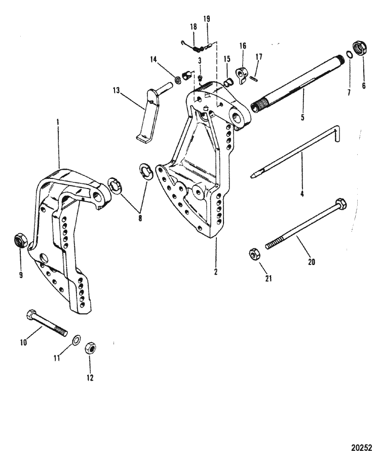

Is it possible to change out a 1983 external trim pump on a 1983 Mercury 150 to a newer hydraulic assembly between the transom brackets?
jeff_32
Aug 12, 2008
44
Only if you change the midsection and clamp bracket assy.
Can it be done with these parts in the pics or does it also need the driveshaft housing?
Dukedog
Oct 6, 2009
3,521
yeah with those parts.... plus 3 ram tilt/trim assembly
"driveshaft" (down housing and /or can) housing will work on either clamp/trim assy.
