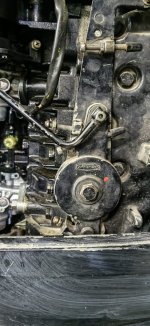

The motor idles good but it seems to be REVed up, I don't have a tachometer yet but will get one this week to confirm revs, anyways, if somebody has some instructions to do this adjustments will be greatly appreciated. The serial number of the motor is 4967035. Se a picture attached of the throttle arm, can some one tellme what is the function of the 4 set screws?

Thank you merc850 this is much clearer than the SELOC, which is the Idle stop screw? I think I have identified all others.

The manual I have (1975-1978) only shows the instructions I've posted but on further inspection I notice that it's for up to serial Nr. 4576236 the posted picture is for ser. Nr 4576237 and above, so much for downloaded manuals!

Thanks marc850! those images look much more like my outboard I will check later tonight. What is the manual you are taking this scans from? I might want to look to see if there is one available to buy it, looks very good.
