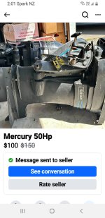

Hi team, just joined the page, I am in nz and have purchased a 50hp mercury not sure what age as its only got a serial# no other tags, unless someone can tell me how else I can find the age. Looking for manuals so I can get into it. Anyone have any ideas please?

Hi team, serial# is 4071518 and this is the motor I got from market place

Just looking at the Decal, likely a 72 or 73, with a slight chance of 74

Based on the Cowl and Faceplate Decals, I'm almost 100% certain it is a 73
A 73 has Mercury Marine on the Face Plate, a 72 would have Kiekhaefer Mercury
In 74 the two blue stripes would have not gone under the Face Plate.
Granted, this is my 1984 115, kinda looks like a 71, cause I put the 71 cowl on it, except for the Bottom Pan and the Cover below it. To me the Best Looking Cowls were the Red Decal ones
