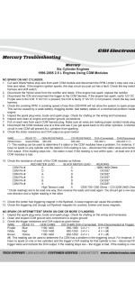

According to CDI, stator ohms reading on one sheet is 380-430, other sheet 660-710. Which is correct?

Stator and Trigger - Are they within specs?

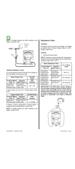

Posted two images/sheets. Both have different specs for ohms resistance for stator. Which one is correct? OR since ohms varies due to temp, is volts the more accurate/leading test?
Trigger considered bad when it does not pass both ohms/volts test?

one is an OEM spec and tha other is a CDI spec.... you chose.
you might call CDI and ask which one they recommend!!!

I can see/know the difference between OEM/CDI. Both sheets list different specs. Both t/s doc is from CDI, so it should be the same across the board not different specs depending on what page you look at.
is your stator a cdi or oem merc?.. its not tha first time a CDI product had different specs compared to a Merc oem part.. your cdi sheet also gives ya an ohm spec for a trigger but tha oem says no... go figure.. call cdi!... justa another reason (not main one) we almost always threw tha "electronic" junk in tha trash and went with switch box stuff.. good luck and hope ya get it figured out.................
