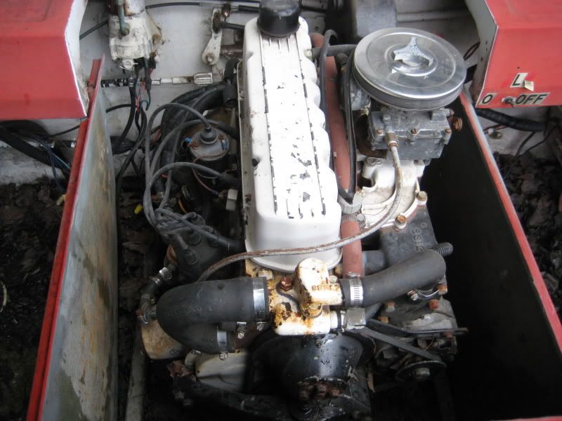

It's good that it seems to have a mercruiser pre-alpha drive system installed... that drive is probably about 20 years newer than the boat, and you can still get plenty of parts for it easily. See if the engine turns with a wrench, then check the starter, and do a compression test if you can. If it won't turn or the starter won't work, pull a head and post some pictures.
If the engine's not totally siezed and rusted solid (it looks from the outside like it might be ok, for what that's worth) then it's repairable, or replaceable with a similar engine. Worst case on the outdrive you'd have water in the gear case, but if you don't at most you'd end up replacing some gaskets there. Bearings in the transom, replace the rubber bellows there too. Cheap, but takes some work and a couple special tools or good substitutes.

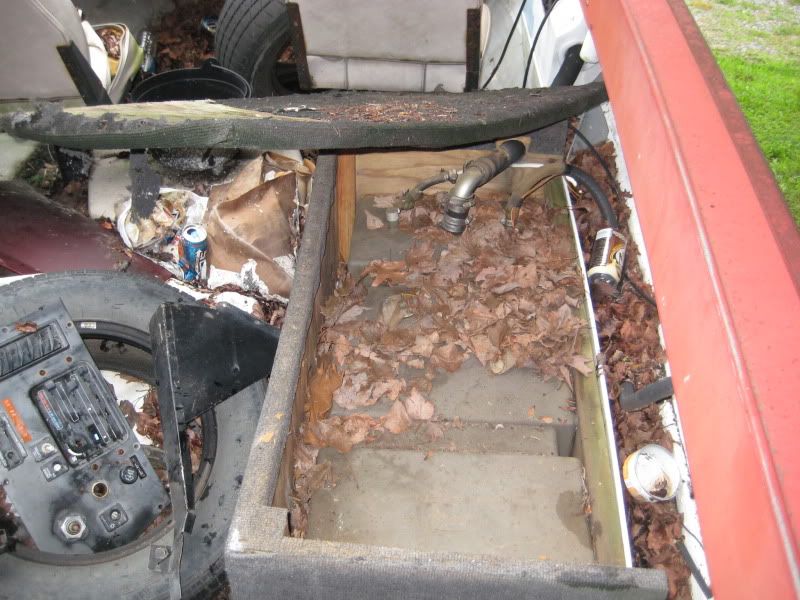

Well, I'm planning on going and cleaning all the junk out of my boat this weekend. So, I went over tonight to get all the water out, so hopefully everything will dry out a little. Also, snapped a few better quality pictures while I was there.
Well, the good news is that I jumped up in the boat and didn't go through the deck. I'm a large guy (as I said before, I don't look like it at all, but I'm pushing 400lbs). No flex at all. The floor appears to be fiberglass, sounds like it's fiberglass, but I won't know 100% until I pull the seats I guess.
I banged around on the transom a little, and it's mushy on the left side if you're standing behind the boat looking forward (still can't remember starboard or port, lol). So, that's bad news, but I think I can handle it. Gives me a good reason to pull the motor and clean it all up.
Anyway, on to the pictures, as they say, the speak a thousand words.

You have a lot of good material there to work with. Lucky for you no one took a saw to the boat to "customize" or "convert" it. The factory foam under the bow deck is still there! LOL! If its solid, keep it because it adds some rigidity to the deck.
Looks like the hatch lid is missing. Depending on the size, look for used hatches on ebay. Hatches are expensive new. Send me a PM for more info on where to get a hatch from a reputable boat salvage company.

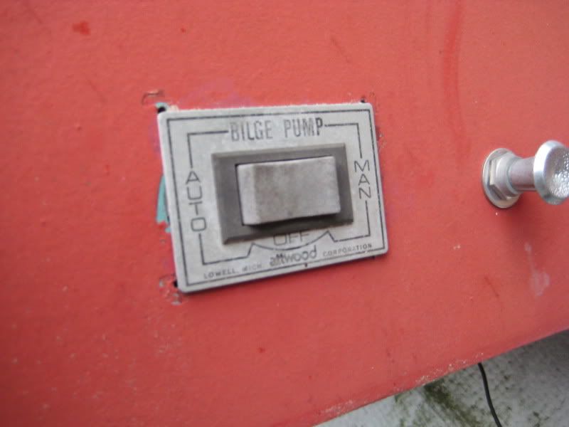

The Attwood bilge pump switch is not OEM, you can still buy that switch.

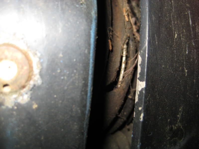

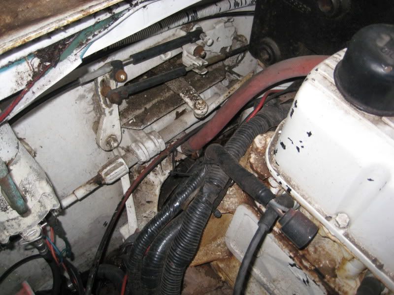

It has a rotary steering system. Cool. If it works, fine, but you might want to replace the cable due to its age.

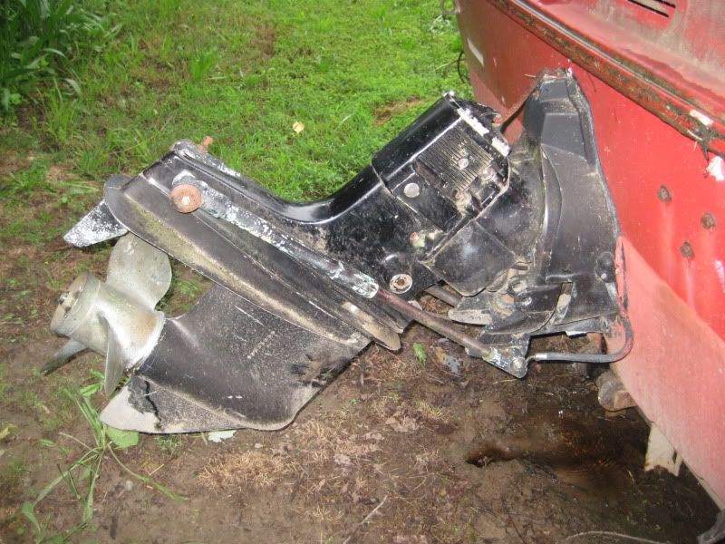

So the outdrive has a few leaks..... :D
Get her cleaned out, strip the hardware, strip the paint, and report on the transom.
Talk about dumb luck! You fell into a good boat for a project!

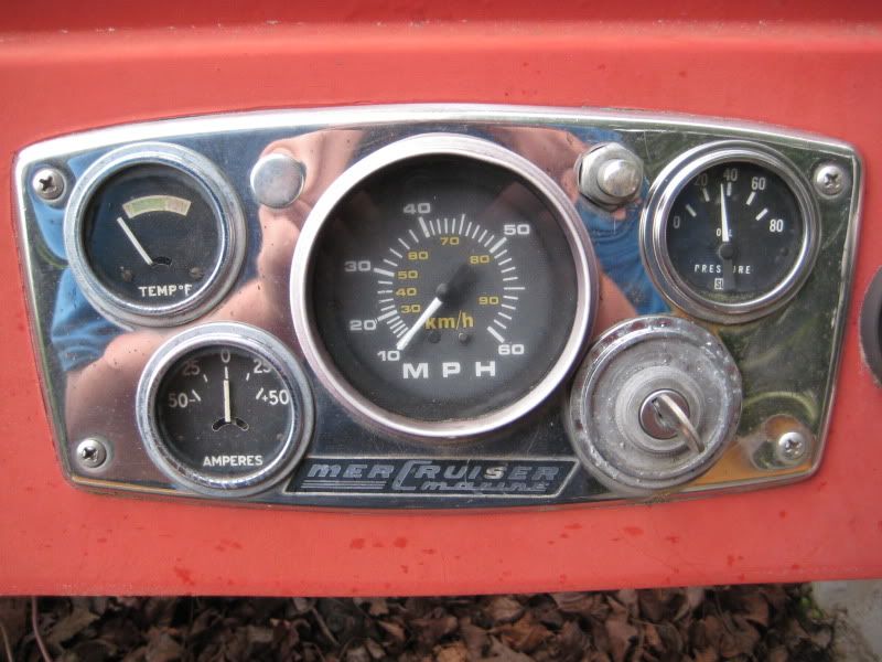

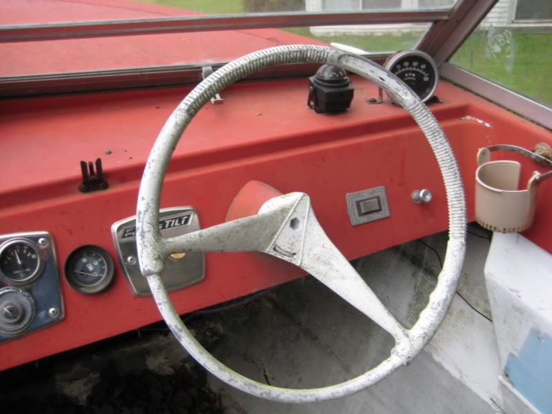

As far as the dash goes, this is my line of thinking so far. If the guages work, I'd like to keep them because they're cool. If they don't, I may try to keep the trim plate and put new guages in the holes.
As far as the other stuff like the blower, bilge pump, lights, etc., I'm thinking I'm going to get a new switch panel to give it a little newer feel.
Still have to decide the fate of the steering wheel. I like it, but it's kind of plain for me. I did turn the wheel side to side and there was absolutely no binding at all, and I could push the outdrive around with one hand, so everything feels good there.

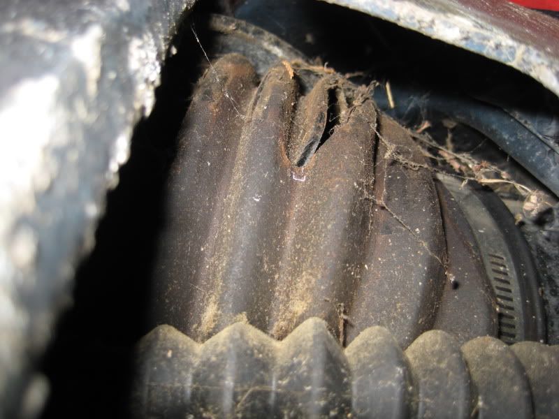

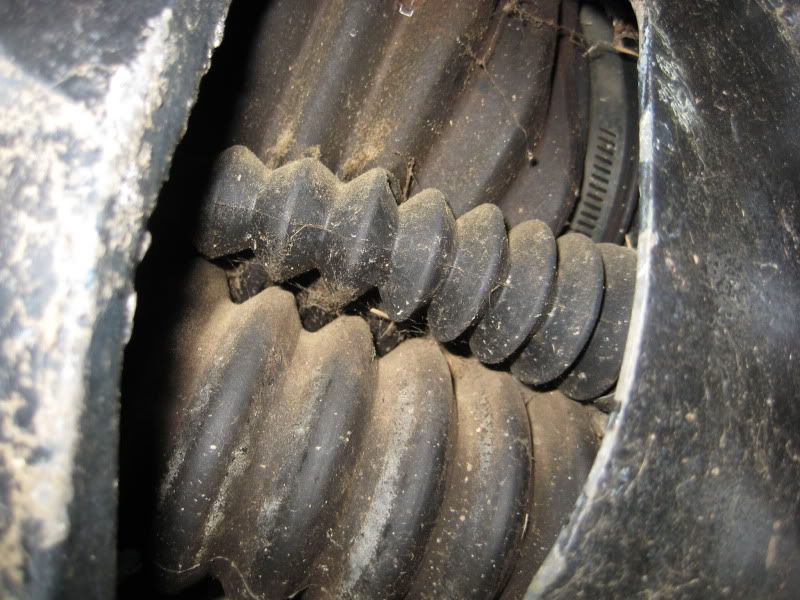

Definitely needs new boots. Although I could only see the one that was split.

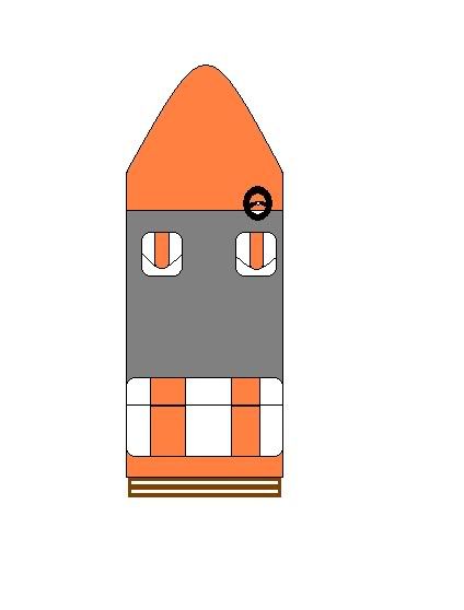

And just a quick MS Paint sketch of an idea for the interior... I'd like to have a more modern type interior, with an engine cover/padded sun deck for people to lay out on, and a bench all the way across the back, with 2 swivel chairs up front. Simple, but functional.
This is just an idea, I'm sure things will change, but it's the basic setup I'm looking for.

Okay, it looks like the boat has had some minor updates, but a lot of the original gear is there.
I'm not sure what drive that is... it's very similar to my MC-1, but it might be an older predecessor. Either way you can still get the transom kit with bellows, bearings, etc.
That trim pump is old, but if it works, who cares. It's completely interchangeable with newer pumps, either the follow-on with the metal tank or the newest model with the plastic tank. The trim rams are an old style, and replacing them with newer would require some work to customize the hose runs. I'd check how fast the drive raises and lowers, check your limit switch functioning if you have it.

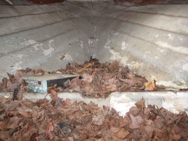

That looks like an old CB on the floor there, or maybe a marine VHF. If it's a VHF it'd be cool to have running, but that's harder to repair.
As has been mentioned you have a rotary or rack steering system, so that's been updated already. If it turns freely you can keep the cable as-is. If you want to replace the steering wheel I'd suggest either a custom wheel from a vintage car or boat, or else a stainless steel "destroyer" type wheel, that also wouldn't look out of place.
The interior glass looks like it's in decent shape, maybe just needs a coat of paint in places like the bow. Same for most of the top cap, that red gelcoat will really look good once it's cleaned up some.
The transom is pretty much to be expected, and even if you didn't have to do it I'd recommend you take out the engine to clean and paint the interior, that'd give you a chance to clean it up too, drop the oil pan, and basically give it a physical. Although it too looks ok, if it's not seized I bet it runs. I can see newer hoses on it and the coil looks fairly new, so someone has done some maintenance.
The fuel tank is a BIG deal by the way. Someone put in a plastic tank at some point, which will save you a lot of hassle. When ethanol started being used as a fuel additive it tended to clean the gunk out of tanks that had accumulated over 30 years and feed it into the carb. Since your tank is plastic it's probably ok, and probably any gunk that was in the old one was taken care of after the install, so you don't need to deal with that. Probably the tank pick-up and fittings are in great shape too.
