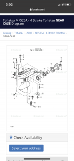

Good afternoon boat friends. I recently got some fishing line caught in my prop and my seal busted. After removing a VERY OLD seal, I ordered the lower seal kit from Iboats . I looked at the diagram and it showed only one oil seal but the kit came with two? I am wondering what the other seal is for?

Was the damaged seal number 15 ? the second one is number 14 ?, if so, it's a O'ring and works attached to the propeller shaft housing 10, there should be a groove at the front where the o'ring sits at. Can change both 14 and 15 as to count with 2 new ones....

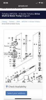

Thanks PVAMV! After some more digging, I found that the other seal in the kit is #32 of the drive shaft and water pump diagram!
