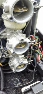

I have a 1989 Force 85 hp motor, runing the motor WOT today it started working good then it started bogging and going slower maybe 50% the speed it usually goes, I opened the motor cover to inspect and noticed there is milky fuel in the carb intake, see the picture attached. Is this normal or and issue? what can cause thisI've read in tbis forum that this could be the reeds valves not working good.

Any water in the fuel?
52,485
What was the temp you were boating in? Do you have a fuel/water separator filter?
Most likely you were boating in cold weather with water in your fuel

That milky stuff is normal !
Never seen it before that's why it called my attention.
I ran the motor today again in it is erratic, it idles good, then going from stopped to WOT ran very bad for about 5 minutes then from nothing it started running very good for about 10.minted like it's something was unclogged, then I stopped and repeat and was the same rough start for some minutes and then it ran good.
