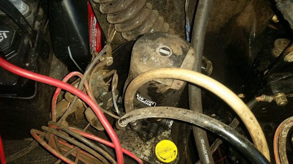

I'm dealing with milky oil in my trim reservoir. I guess my question is what's the best/worst case senario here? I got the boat running great for the most part this is one of my final issues.

The outdrive oil reservoir? Sounds like you have water leaking into your outdrive and it's made its way all the way up to the reservoir. I would suggest pulling the outdrive drain plug and see if you get milky oil there as well, if yes, it's time to pull the drive off and do a simple leak test to find where the water is coming in.

This is a leak from the hydraulic trim rams and is not connected to the outdrive gear lube. You either need to rebuild the rams or replace them. Rebuilding is easy and can be done in an afternoon.

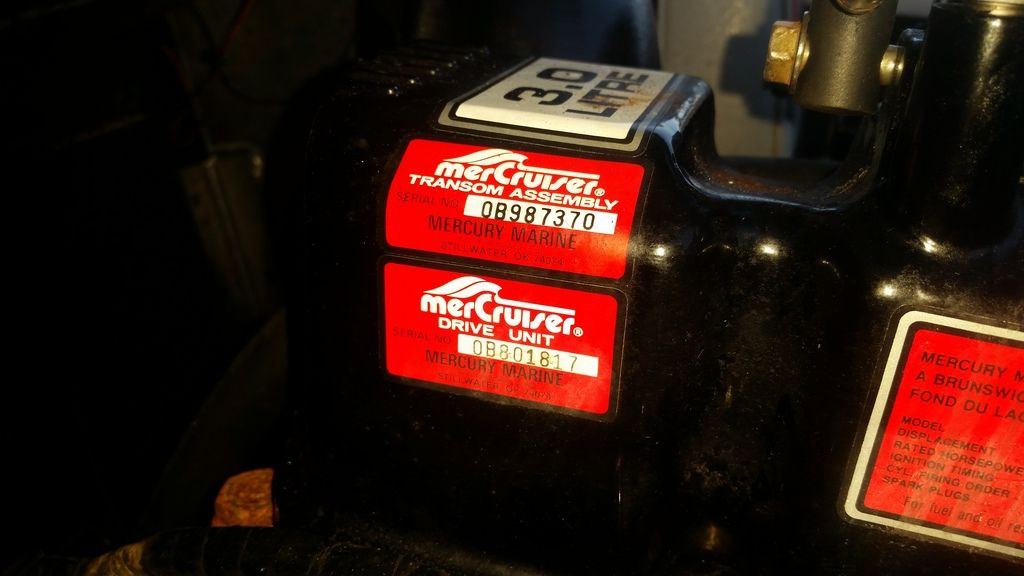

Thanks for your reply I'm including pictures of the trim reservoir and drive unit serial number. I tried to look up the number and couldn't find anything on it. Although the previous owner said it had been replaced idk if he updated the stickers or not but they look newer. This may be a stupid question but what are the rams? Are those the hydraulic arms? You just figure bad seals? Approximate cost? I appreciate your response!

You have an Alpha drive and would use seal kit 25-87400A2 ($30 per cylinder) to reseal.

May be wrong, but it sure looks like there has. Even water in there. Just looking at the photo of the trim pump.

Yeah I kind of suspected it after I thought about it. It was all covered in black stuff until I wiped it off. Not entirely sure if it just got some sea water or was rain or completely sank. Unfortunately I don't have a lot of details on the history of the boat. I know the previous owner was pretty much clueless on the mechanics of anything. I've been considering gutting the entire boat and replacing a lot of the interior and doing preventive maintenance. Then again I imagine it's not gonna be cheap. Most likely I'll fix it up a little bit and sell it in a couple years for something big enough to handle Lake Erie that's nearby me.
