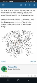

Another guy said this is how to do it.

I assume your motor is a 4 stroke. If not a model# would be very helpful
There should be a Friction Adjustment on the Swivel Bracket #23

I think found your screw. It broke with hardly any pressure at all. I'm assuming that it's still fine too use ?

I'm assuming it's 72 that I broke. I think I'm will just leave things alone before I really brake something
Or I guess 65 would be the bolt 75 would be the spring
The spring #72 looks Ok but you appear to have sheared the head off the screw #65. Perhaps you will be able to grab hold of the remaining bit of the screw with vice grips and remove it. Then it's just a question of sourcing a replacement screw locally.
