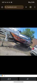

This is 96 Doral speed boat, cuddy with 4.3L mercruiser. the owner does not know how weight it is? Can any person figure out how heavy it is?

Bayliners of the 80's had a small cuddy in the 18ft range.
The port windows in the cuddy are a tad different which from what I've found on Google changed through the model years. So its a very safe bet you're not looking at a Doral but rather a Bayliner.
Smallest cuddy with an I/O is 19ft at 2200lbs. By the time you add in everything we've been telling you - gas, batts, trailer, etc - you are over your max tow on your Minivan. You can't escape that. Sorry.
If you insist on going down this path, you may very well end up a YouTube sensation for all the wrong reasons.
52,787
Going to agree, looks like a mid 80s Bayliner capri cuddy, including the little bend in side window top rail
The big red flag is why is it being sold as a Doral?
Look up the HIN

Are you talking about this boat? The owner told me that it is 96 Doral speed boat. and he cannot afford me the user mannual. How can I get the detail for this boat? including the model ,year. I can find the engine serial No. sure

Yes, that boat is not a 1996 Doral. Google 1996 Doral 216cc (the smallest cuddy the have) and you will see. Then Google 1985 Bayliner Capri 1850 cuddy.
The boat you are looking at does not match the description

and the boat he is looking at may be stolen / improperly registered.

User manual is about as useful as a long tailed cat in a room full of rocking chairs. It will tell you the pointy end is the bow, and the end with the motor is the stern. Not to run over something and basic rules of the water.
There should be enough red flags now that you should be walking away from this boat.
*It's over your maximum tow for your minivan. You are in denial if you think otherwise.
*It's not the right manufacturer or model.
*Owner has no clue what he has. Hint: It is listed on his ownership papers and it will match the HID on the boat. IF the owner is insisting this is in fact a Doral, have him supply a picture of the HID AND the paperwork showing he in fact owns it.
