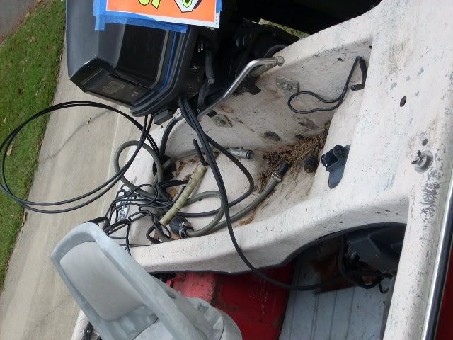

The plan is to do a thorough cleaning followed by mounting the single 115HP Mercury outboard with 20" shaft. I want to get the boat usable while doing the restoration. Being retired, I have lots of free time but not lots of money, so the whole project could take awhile. Maybe. Heh heh.

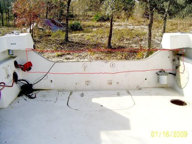

Later on I'll add another 115HP Merc and have twins hanging on the back. In order to get the 20" shaft motors mounted, I'll notch the transom per the animated diagram below.
