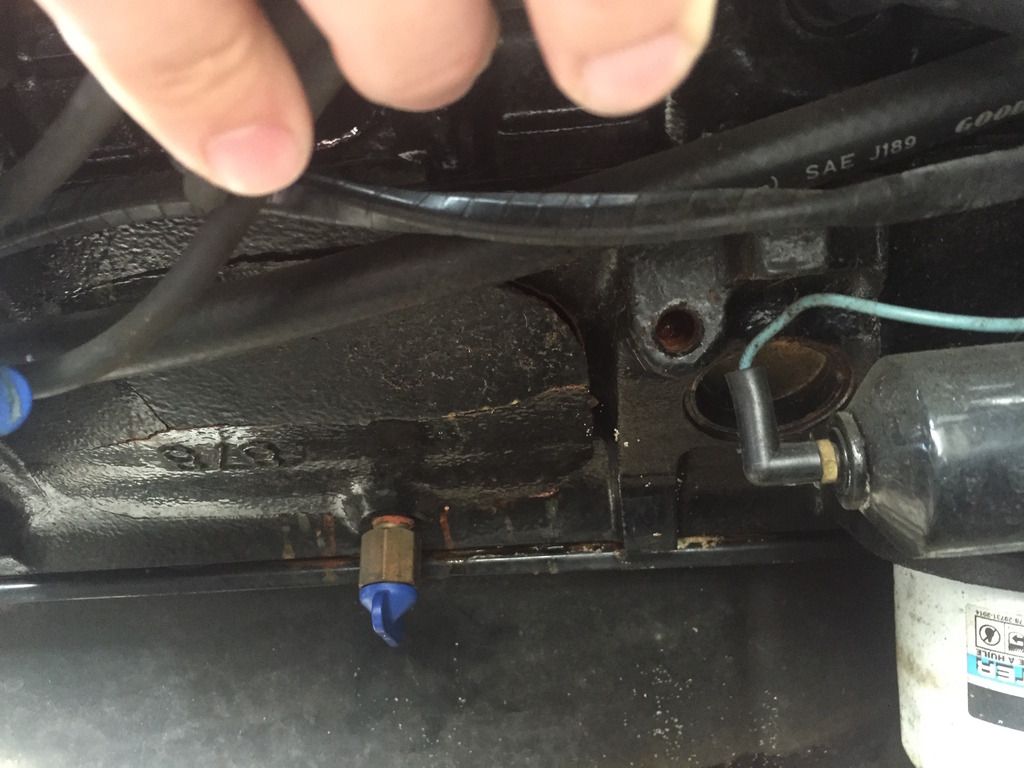

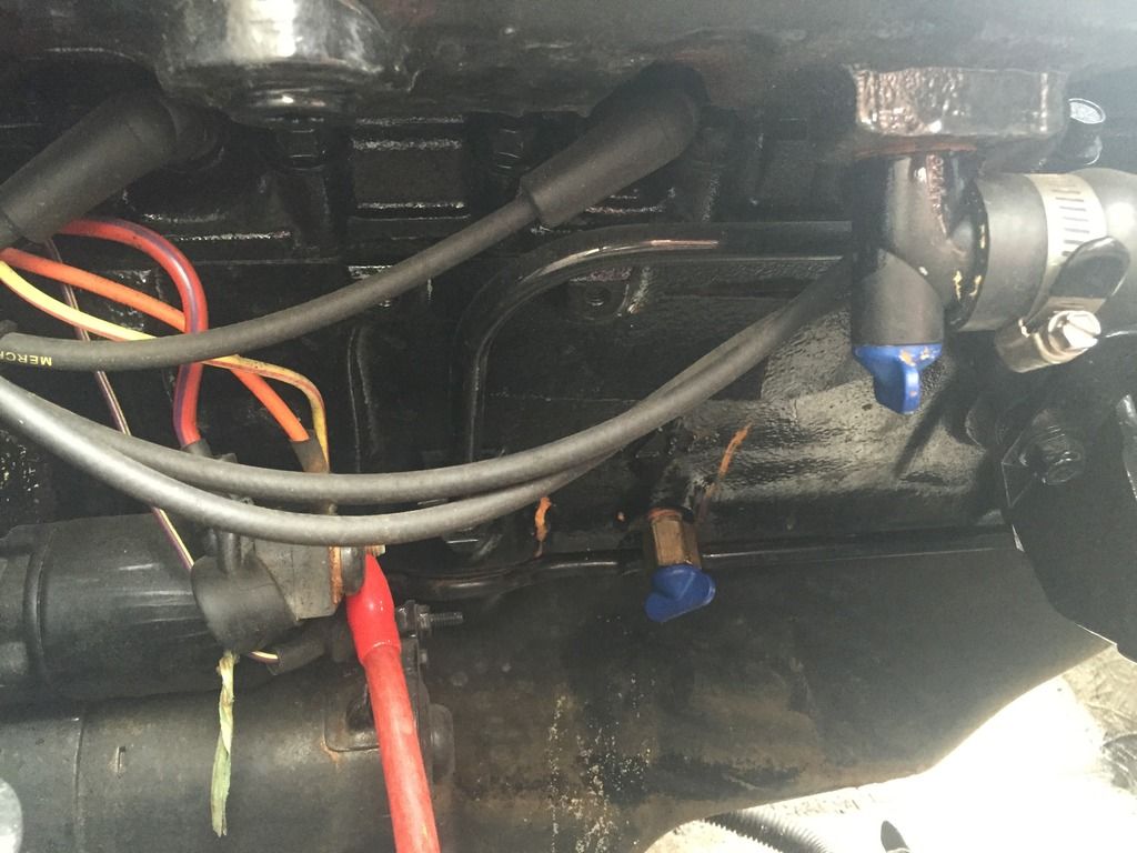

And so the adventure begins. I took the leap and purchased a 1999 Byliner Capri 2050 LS. The exciting and terrifying part is it has a cracked 5.0 L block as the previous owner somehow failed to winterize it properly. Luckily with the help of this page and my mechanical background, I was able to identify the damage and get a deal.

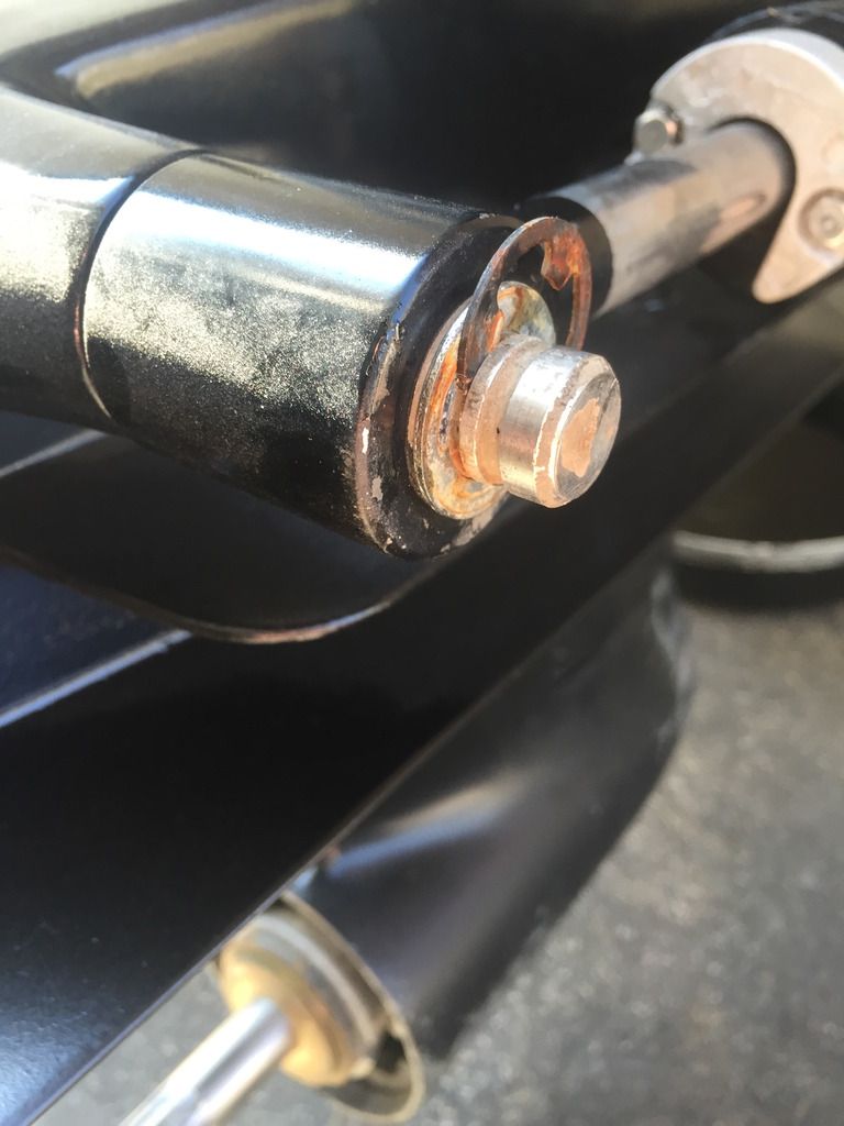

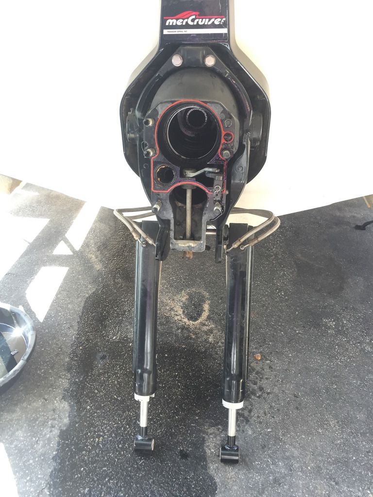

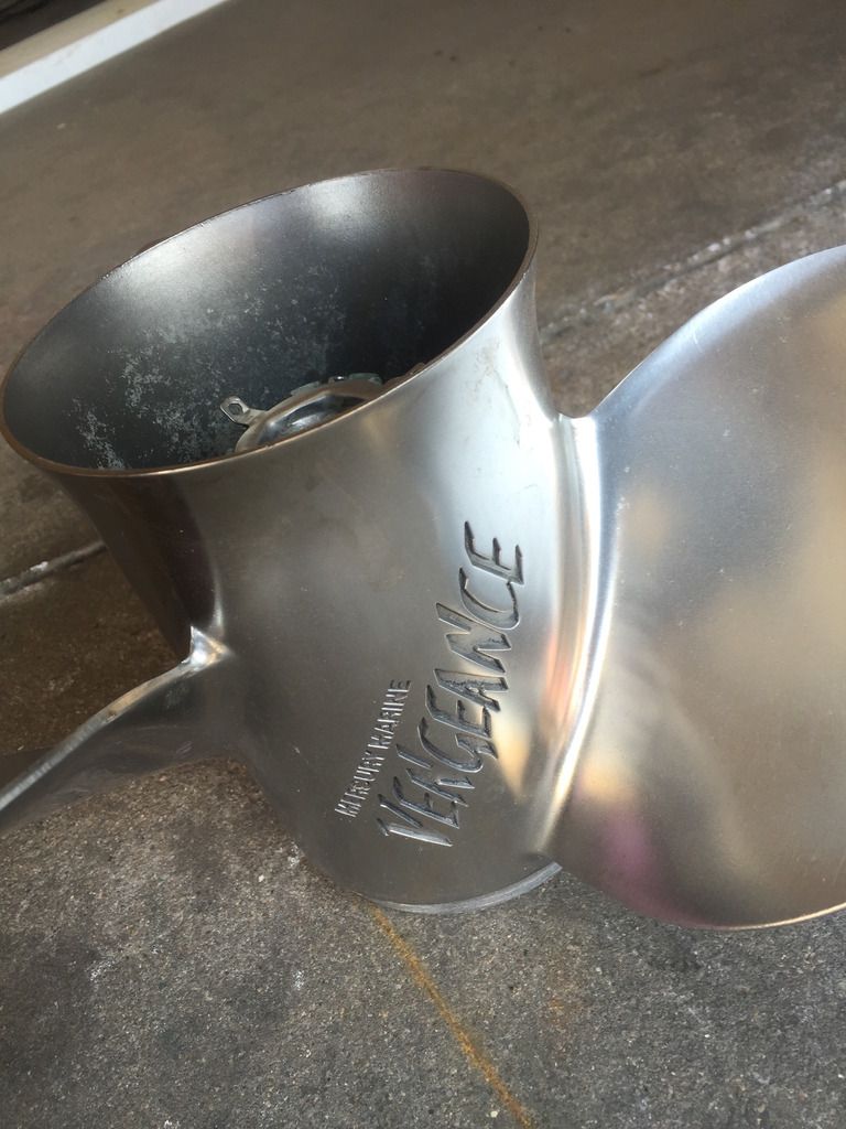

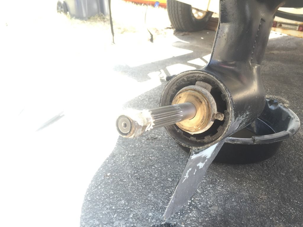

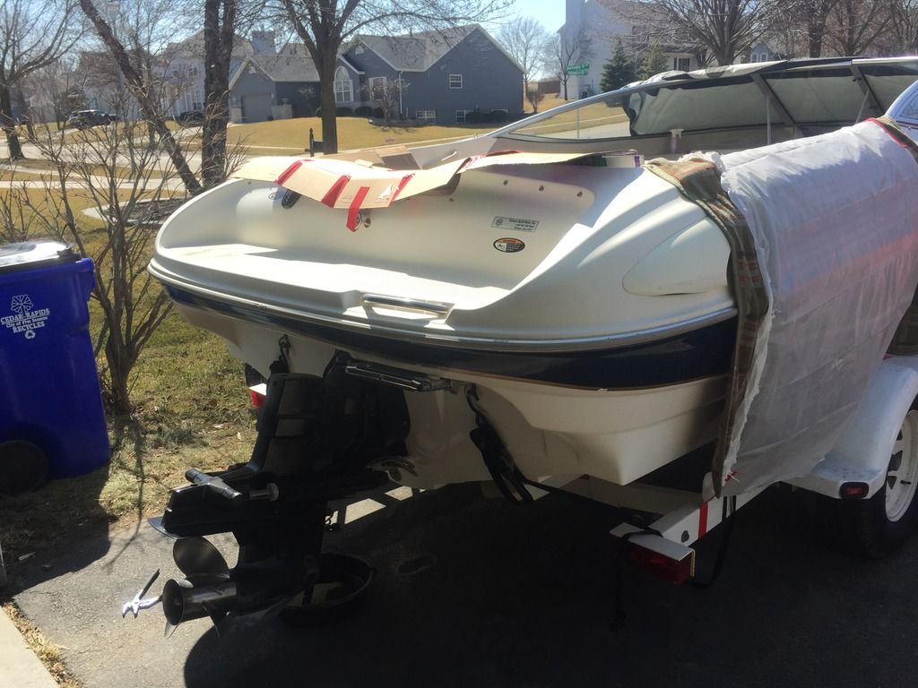

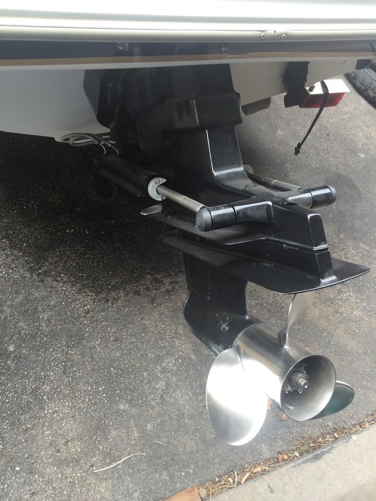

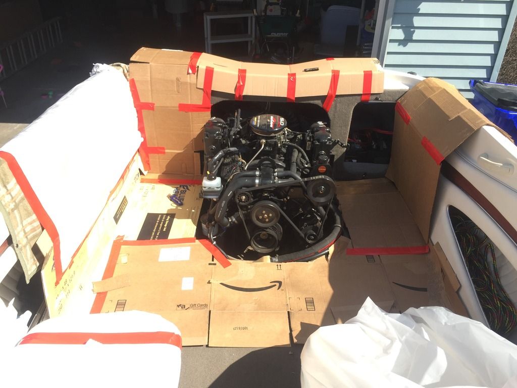

So today I started the removal, taking a break right now ;) Heres what I have right now.
The interior on this is really nice so I am going to do my best to preserve it.
Removed speed sensing tube. Lowered the outdrive, drained the lube, disconnected the battery, engaged the forward gear, and removed the screw.
Removed plastic caps, c-clips. Used a mallet to nock the pin to remove the rams.
Gave er a tug and she hoped right off.

Everything is loose and disconnected and ready for removal tomorrow. One problem though. The cherry picked I got won't reach deep enough to hook and lift out of the hole. Any other advice for removal? I'm thinking of calling a row truck or building a wood gantry.
alldodge
Mar 8, 2009
42,572
Have a stout tree you can pull under, otherwise the gantry or Gin pole might be best bet.
