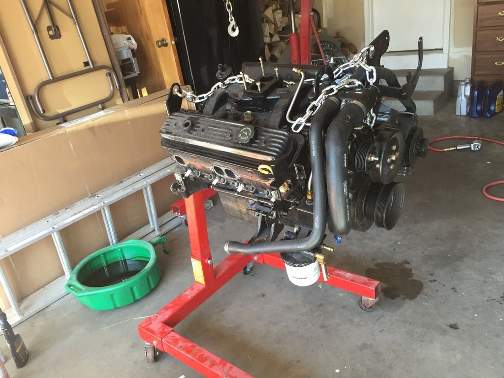

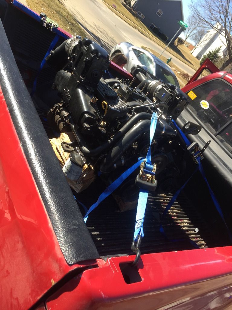

Removal day. Couldn't find a tow truck who was willing to pull my engine for me but got lucky with an awesome shop. They charged me $20 to grab it and put it in the back of my truck. Only problem I ran into was where I disconnected the exhaust. Works much better loosening below the 90 degree bends. Now she's out and on my engine stand coming apart and getting cleaned up.

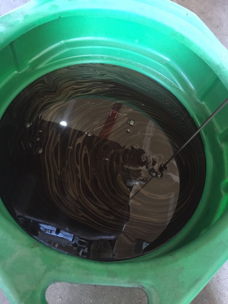

Lots of water in the oil.

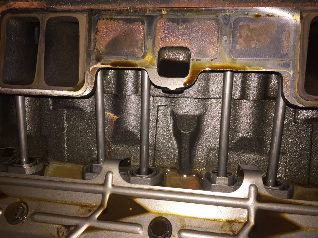

Another look at the crack.

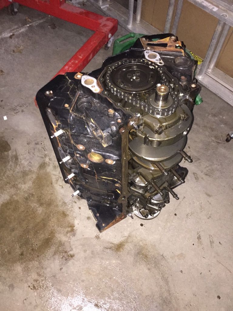

I ended up going with perfprotech.com on the manifolds and risers. I was leaning towards the GLM's until I read all the negative reviews on here about them. After all of this work I really don't want to risk having cracks in the manifolds. Price was pretty comparable too. Today I finished all of the disassembly of the old block. Im going to start getting everything cleaned up and prepped for the new block, which by the way shipped today and should be here by this weekend.
Might be hard to see but this explains all of the water in the oil. Both sides of the lifter valley were cracked.

Other then the crack the motor is clean inside, shows it has been taken care of
sub2010ss
Feb 17, 2015
276
It is and it's sad how clean it is but so useless. I'm thinking it has very low hours with as clean as the boat and engine are.
