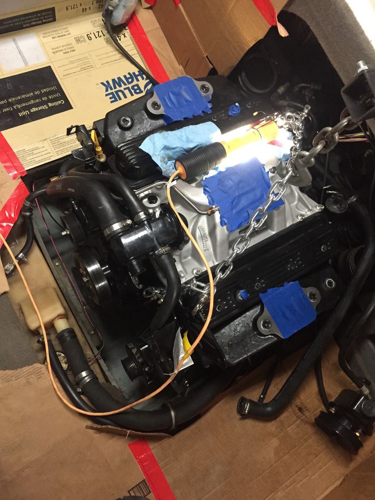

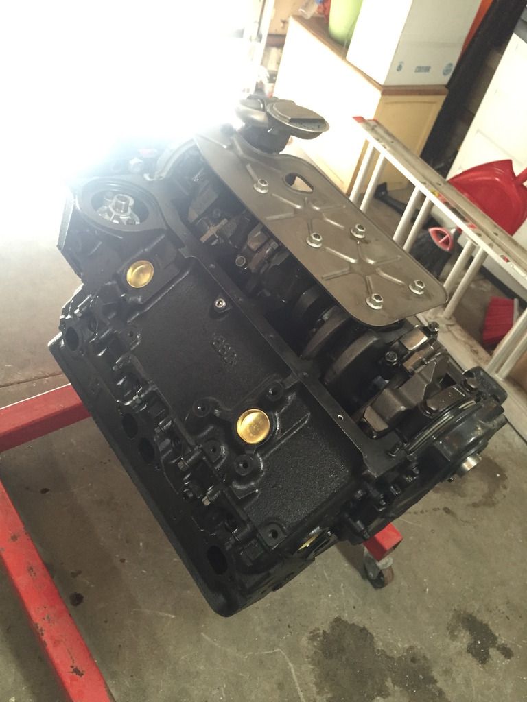

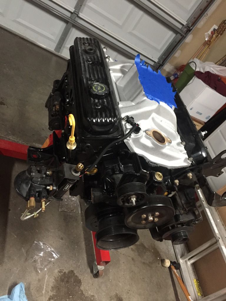

I'm ready on the grease. Heres a couple of updated pics while I wait on my outdrive parts now. It's a waiting game I'm playing. Yesterday afternoon I got my long block in. Finally. Ran into some issues with that as well. Rapido Marine shipped the engine with a pretty crappy description and stated on the BOL that it had 11 parts. Well apparently the shipper thought they could drive this crate to my home in a Semi and we'd be able to open the box and take out the 11 pieces weighing 350lbs. Wrong answer. They were supposed to show up with a lift truck. We worked some magic and found a local show with a forklift and took care of it, but either the shipper or the machine shop screwed up big but neither will take any blame. Either way, I got er.
This is far as I made it last night. Just a few more things to get on and Ill be ready to drop it back in the boat.
alldodge
Mar 8, 2009
44,289
Lookinf good nut I would put the responsibility with Rapido Marine. They didn't have it packaged strong enough for what it was. The engine should have at least been in a tri-wall box, that's just a single wall. Glad nothing was hurt and the build can continue :D

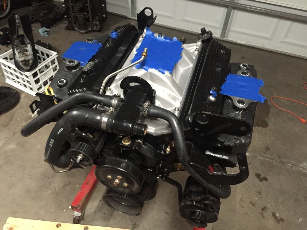

Late night and it paid off! got the engine in, aligned, and bolted up! Still have a lot of work to do but this was a huge step. The alignment tool indicated one small adjustment. I checked it twice after adjustment and both indicated even tracks all around the tool. Ill check it one more time in the morning now that its all tight.

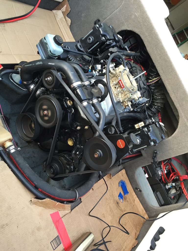

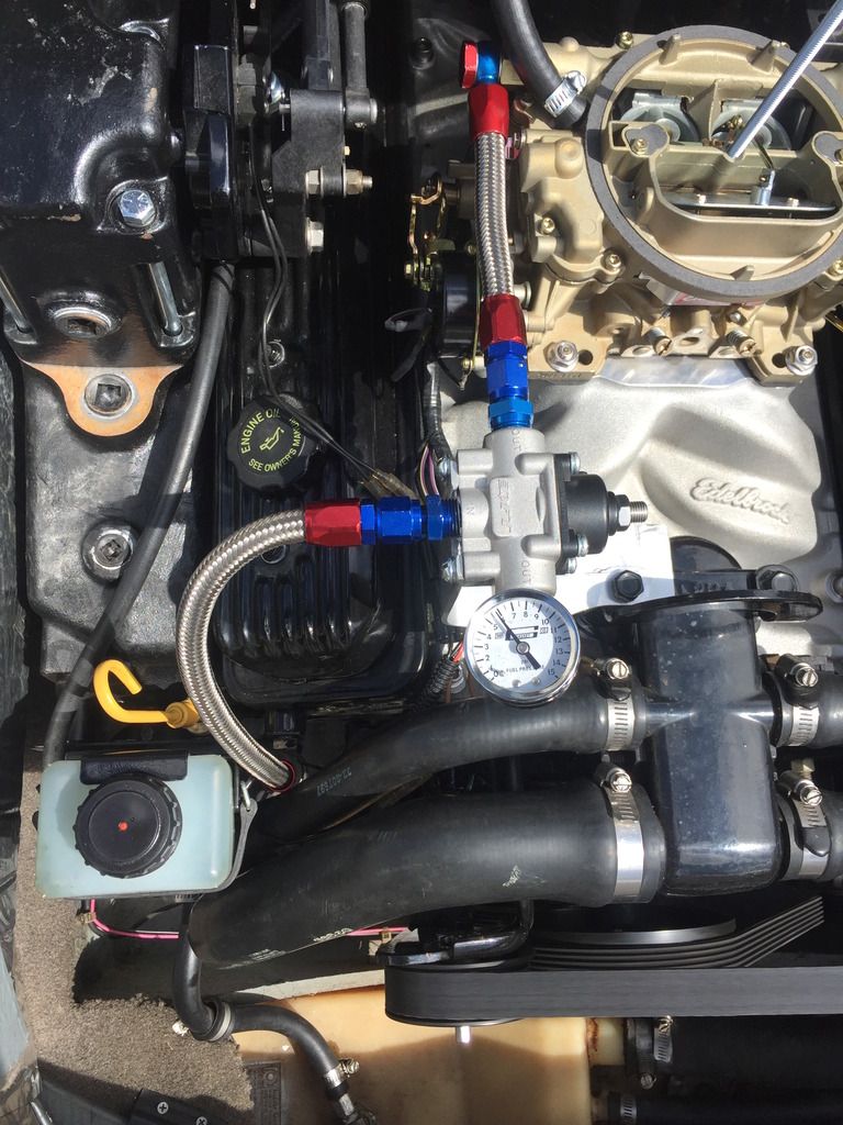

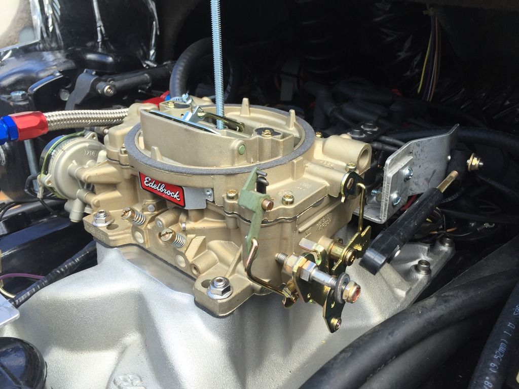

Pheww! Another long day! No picture updates today, guess i was too busy running for parts and swinging wrenches. Ill get some pics tomorrow of some of the issues I had and work arounds. Today, I got all wiring connected, exhaust risers on, carb on, plugs, wires and distributor on. Im pretty sure its ready to start minus the outdrive. Let me tell you about the throttle linkage and and carb. What a mess. My old throttle bracket definitely wouldn't work. I looked all over and there were no universal kits that would work here in Cedar Rapids. My only option was to make my own. Turned out really good, looks on as well. The new carb only had one vacuum port which was located above the throttle blades. I had to screw a port into the intake for the PCV. The old corrugated tube wouldn't work with the newer cleaner, so I connected that to the port that was on the carb. Finally the fuel line. Again, local parts stores didn't have the right connector. So I have a temp rubber hose just to get it running while I get the right part from online. Before anyone flame sprays me it is just temporary. Tomorrow I will get the outdrive back together and installed, check over the engine bay, get some clean fuel and give starting her a go. Pics to come.

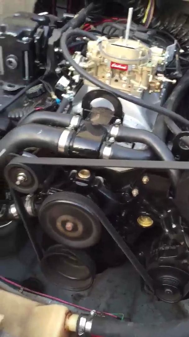

I did. I wouldn't recommend doing it the way I did but it worked. Today I installed the ourtdrive, filled it up, did some last minute checks, hooked up the muffs and started her up. She fired as soon as I got fuel into the carb which was a task in itself.
I have an electric fuel pump and it didn't seem to want to run? So I jumped it to the battery, and it ran fine, primed the lines. Tried the key again and bam off she went. I had to make a few adjustments to get her in time and get the idle set right. Then let it run between 1800-1500 rpm for 30 min. Ran great, came up to temp, great oil pressure. After I let it idle down to 800 RPM and it purred like a kitten. The only issue I can see now is my batteries aren't holding a charge and I lost my hull drain plug somewhere.

It is a wonderful sound to hear a new engine for the first time.
It sure was! I was actually very surprised it fired up right away. I tried getting a video loaded, but haven't had much luck with that yet.

Nice! Are you going to have to tune that carb or is it setup for a 350? I'm looking to swap out my Rochester at some point.
So far all I have done is adjust the idle settings. Ill have to get her on the water to see how she runs under load.
