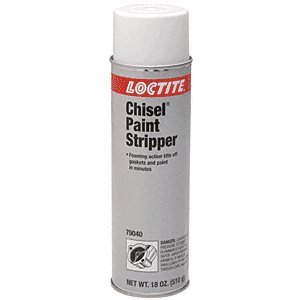

I have to read this stripper make sure it does not eat the fiberglass.
EStack
Jan 28, 2010
47
Re: My boat questions thread
It is called 'Chisel Paint Stripper'
Cadwelder
Aug 30, 2010
1,780
I wouldn't want a chisel of any kind near my hull, period. Fiberglass and chisels shouldn't even be in the same sentence.....
Chemical type strippers or sanding equipment is the way to go....
EStack
Jan 28, 2010
47
No it is a chemical. And it BURNS the hell out of you. It is just called that. The warnings say it can cause cancer.....lol. I use it at work removing seal glue off the military vehicles.
Cadwelder
Aug 30, 2010
1,780
Whew...never heard of the stuff....just read the label and see what it says about fiberglass.
EStack
Jan 28, 2010
47
Yeah I gotta read it. It causes a ton of body related illnesses and cancer to humans. :/
