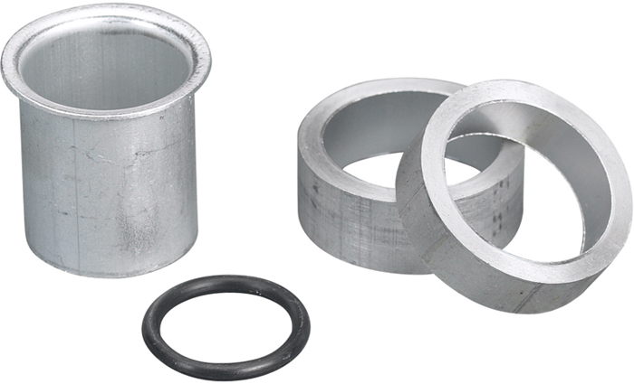

BF, I also had the same pitting in the transom, and used a similar dremel bit, took me about 3 hours to 'grind' out all the corrosion pits, then treat with acid, and fill the pits.
I believe the transom drain is very similar to the splash well drain, you should be able to install it with the moeller tool. but there are kits out there with the thicker tube spacers for .040 and .090 thick transoms and an o-ring. I haven't removed the one in my boat, so I'm not sure if its the same.
Drain Fittings Kit 020848-001 - Moeller Manufacturing Co Drain Plugs and Tubes - MarineEngine.com

That's the tin boat specific drain tube setup astor. Hull is thin, so you need the spacer rings.
They're the ones! iboats has them as well. It's for 0.040 to 0.090 thick transom skins...I believe ours have thicker aluminum (0.1"?); I have a few extra splashwell tubes i can trim to fit if the one provided in this kit is too short...or i can shave one of those spacers on a belt sander.
