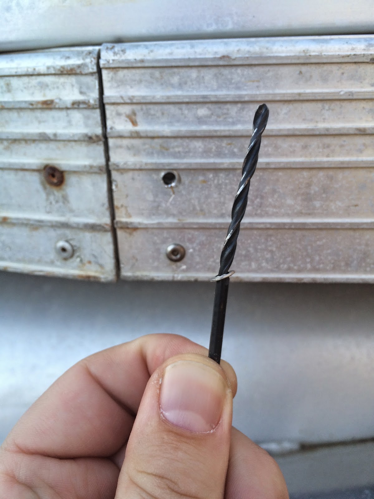

I had a little time this afternoon to work on the teardown again.
First lesson learned...don't use cheap tools. I was going to drill out all the rivets on the side rails, but the crappy drill bit bent on the first one!
So I decided to take out the bench seats on the back of the boat. They weren't bolted down which was nice. They were very heavy though and as I was tossing it off the front of the boat, I accidentally smashed the port side head light. Oh well, I wasn't going to use that anyway.

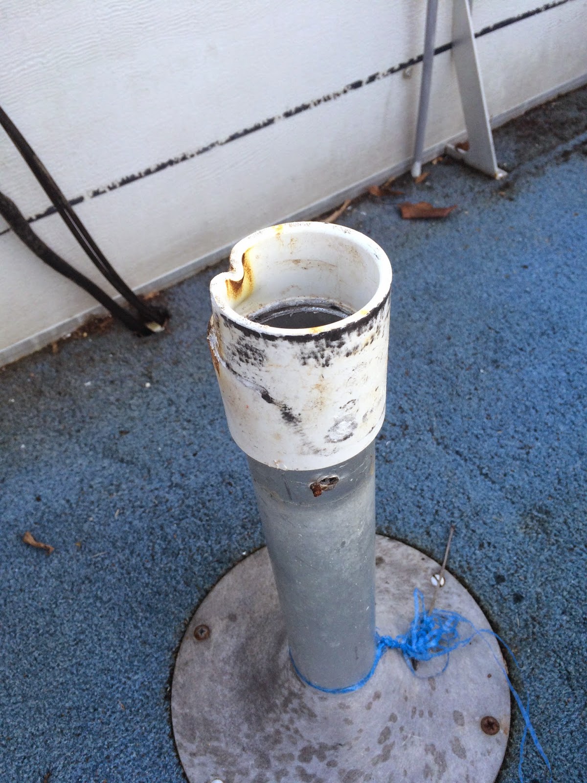

This is what the back of the boat looked like after the bench seats were gone. It's all coming out so no worries.
The table was actually kind of hard to wiggle out, but the captain's chair came right up.
The base of the captain's chair was done very professionally.
I threw away a lot of things, but I was able to salvage the Bimini top, the table top, the captain's chair, the old anchor, and the old gas tank. I am only using the hoses off the old gas tank. I am planning on getting a new one.
