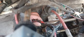

Well made it through the work week, time to troubleshoot the problem. Problem located and an easy fix. The positive battery cable wore through and shorted to the negative cable and the starboard exhaust riser. Pretty sure it was all still original wiring so was probably already wearing through the insulation and finished off by the 240 mile road trip.
