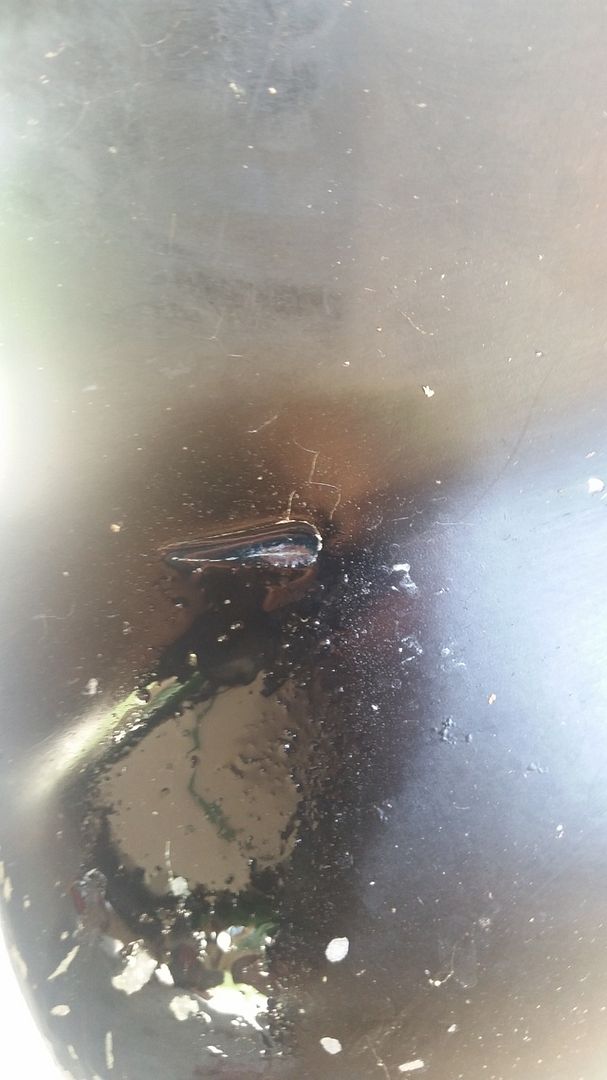

Back off and take the picture again showing exactly where on the engine the port is located.

This port is on the left side of the lower unit at the foward end just above the bulge for the gear housing.

Well that means it's a drain for the mid section. Since exhaust gasses and cooling water pass then you have combustion residue including unburned oil and water. Normal. If it were below then you might be thinking about the gear box leaking, but not with it above.

Thats what i was thinking but what is leaking is nice and blue like the lower unit oil. If it really is the mid section drain maybe the shift shaft seal? I just changed the water pump so i know the drive shaft seals are good.

Could you provide a better photo, one not taken at some odd angle and lousy lighting? It really is hard to figure out what is I looking at. Is that a gouge? One more thing, wipe the oil off
