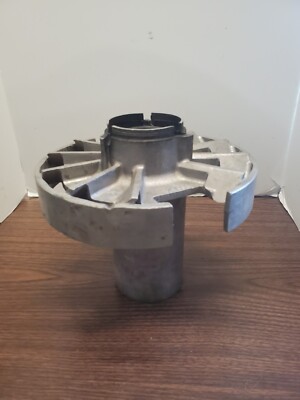

I have a 2005 Johnson 90 2 stroke model J90PLSOA. I am looking for a test propeller, so that I can run the motor in a tank under load. I am not clear on what test prop. will fit my motor. Can someone point me in the direction of what to buy?

The issue at the end of last year was the engine would not idle when warm. I have found that at least one cylinder clearly had bad reeds. So, I replaced all reeds and intake gaskets. I am hoping that the problem is fixed. But, I want to test it under load before I put it on the water.
Also, I picked up a spare motor that is exactly the same . I was told that the spare motor runs, but doesn't run well. I didn't pay much for the second motor. I figured that if I can not use it as a spare, I can use it for parts.
Being that I now have 2 of these Johnsons, I figured that a test prop. would be a good investment. I already have a tank.
I am seeing test. props on ebay. But, I am not sure what will fit.
