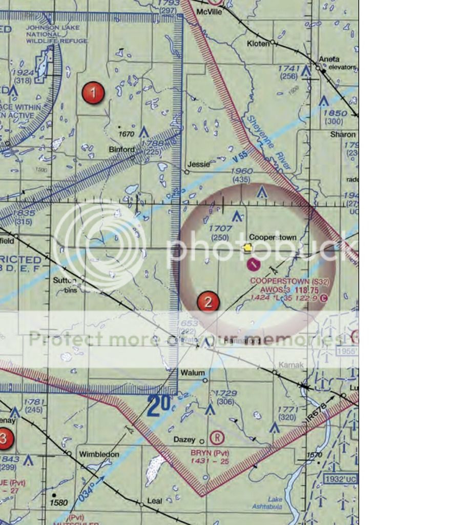

Backstory: I am taking my Part 107 FAA knowledge test this week to get my Remote Pilot certificate - small UAS rating.
Question:
Sectional chart except provided:
I'm confused as to how I can determine the aircraft's position based on the pilot's transmission on CTAF. He states he is midfield left downwind, which I understand, however, if I don't know if he's landing North to south, or vice versa, how can I be sure which side of the runway he is on? Is the "Left" in his transmission just expressing he is flying a standard left hand traffic pattern, or is the "Left" some sort of reference between himself and the airport?
I've tried to wrap my head around this every which way, but it seems that I must know which direction on the runway he will be landing before I can figure out which side the downwind leg is on! I'm sure I'm missing something simple!

Not a rated pilot, but I think I've got this right:
Runway is 13 (130 degrees) ... and he is in a left traffic pattern on the downwind leg ... he's got two left turns to line up with the runway on it's North(ish) to South(ish) axis (130 degrees) ... So, the aircraft is East relative to the runway.

Ah! Makes sense! I didn't realize the runway number correlated to degrees, but was beginning to wonder if that was the bit I was overlooking. That's critical information that is not covered in any of the 107 study material and probably wouldn't be known to remote pilots unless they were familiar with manned aviation stuff.
So, if like altitudes on the sectionals, some of the numbers are omitted in the runway numbering, if I understand then runway;
06 = 60 deg
10 = 100 deg
26 = 260 deg
35 = 350 deg
And so on?

Just googled "runway numbering" and can confirm. Thanks Southkogs. This simple question had been pissing me off.

Yep, knew the answer (the practice test told me), just didn't know the why! ;)
Only way I knew, is I have actually flown into that airport a few times, but it does not sound like they provided all of the information required to answer the question with the correct amount of understanding.
