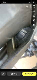

Hello I need help finding out what this parts called and where I can get it. It’s the black plastic thing in between the carbs that syncs them to open and close at the same time. There is 2 of them on the motor and I broke one of them when taking the carbs off. The motor is I believe an 85’ Mariner 90hp. I can’t find the part anywhere and every design I look up for my motor it doesn’t show this part or it’ll show a different one. I included a vid and serial number for reference. Thanks.

It is called a coupling.-----Your location?----Lots of used ones around.

If I was desperate I would fix that with some fiberglass / carbon fiber strands and JB weld epoxy.

I did a temporary repair on mine by using a piece of wooden dowel. I got scolded by the repair shop when they found it the next day. :LOL:
The repair actually lasted a year. But in the end, I forked over the fitty bux for a new one and all has been well since.

Just $10 in some shops that have parts motors on a rack.-----Make some calls.
