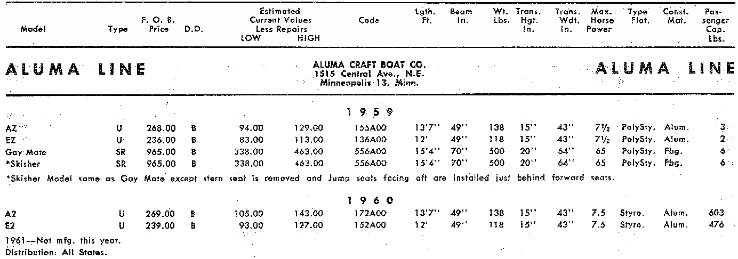

Welcome aboard: Post some pictures up when you can.
THIS topic might help out a bit. And this image:
Comes from THIS site.
AZ might be the model and 302 might be the serial (as long as we're not looking at Arizona registration numbers).

Perfect!
It would seem that I have a 1959 Aluma Line boat on my hands.
I was unsure what the actual weight rating was and what the HP limit was for the boat and this answered the question perfectly.

Another question, though.
Do I need a long shaft or short shaft motor for it?
Despite the manufacturers tag saying it was 15", I measured the transom at 16.5".
jbcurt00
Oct 25, 2011
25,356
Max rating 7.5hp and yep need a short shaft
