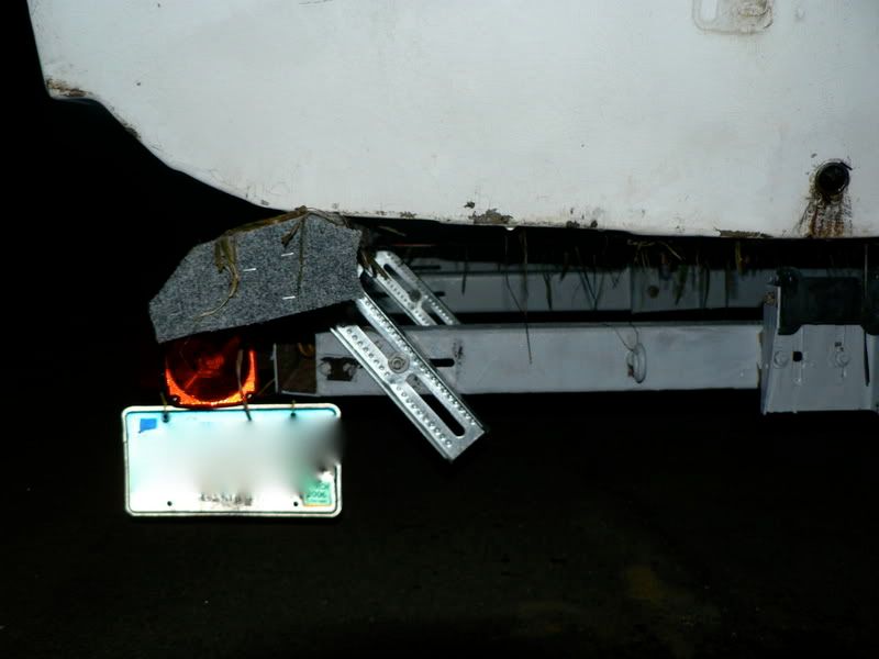

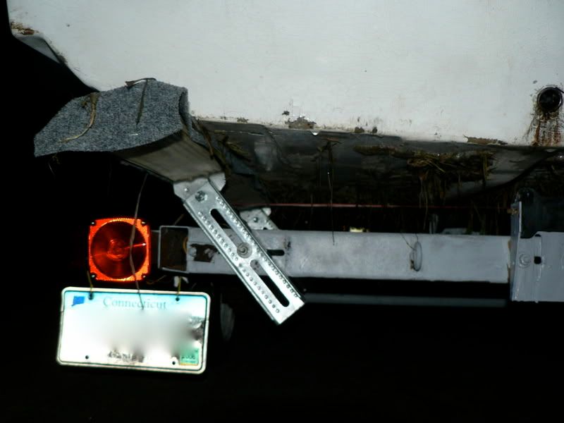

Well my trailer is old and theres really only bunk bracket that ive seen so heres my problem..
i was thinking one of the square U-bolts to go around the frame.
i have some supports on it now so that its properly supported

they make a plate with 2 holes in it for a mounting plate. the bolts go above and below the trailer frame. or you could just drill 2 hole in the trailer.

yah see you got the the ubolts.. thats what i was thinkng

Some square U bolts are in order, as well as some serious cleaning I see.
It looks like it was sitting on the ground or something for a long time? I'd also dig out that drain plug.
You want the bunks positioned under the stringers if possible, and some weight on the keel rollers as well.

drain plug is out.. just wait till you see the picture of it lol.. boat was strapped and froze to the ground for about a week. kind of embarrassing to tell you the truth.. leavin now to get them.. i kinda just threw the brackets on there just so that i can get the boat off the ground. its really light so i figured i would adjust the trailer than start the deck .
