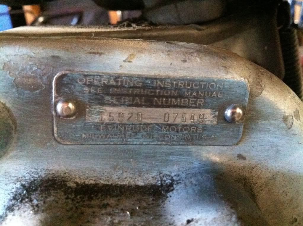

Picked this up today for next to nothing. Tried finding the year and hp rating, but couldn't figure it out. Any help would be greatly appreciated. s/n reads 15020-07549.

Hmm....it looks like a 1957 7.5hp Evinrude....

Evinrude 18 HP Outboard Motor Manuals return to top
Year Model
1957 15020

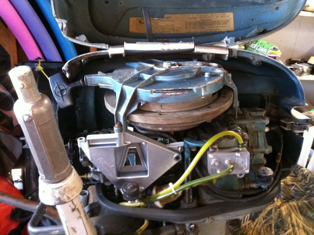

Im not a fan of the location of the fuel pump. Is the pulse line plumbed into the intake manifold or the bypass cover?
+1^^^ had to do a double take on the location...... thats a bit scary!!

Why would it be scary ?? Just because it sits on the exhaust cover ?? LOL.

I was more thinking about the length of the pulse line if he is getting it from the bypass cover. You want that pulse line short as possible, but perhaps the intake manifold has been modified to create the pulse for the pump.

Marine engine is wrong. Most definitely NOT a 7.5hp motor.
The '57 7.5hp evinrude is model 7522 and 7523 for long shaft.
The gearcase is another sure tell that it is not a 7.5hp motor.
Tiller is not original '57 equipment though.

I got my info out of the OMC year and model guide.

Thanks everyone. My back is certainly agreeing with 18hp. Lol
Can I get some pictures of where to move the fuel pump to? Thanks for pointing that out.

first pic is a 10 hp, getting its pulse from the bypass cover, second pic is a 5.5hp, which gets its pulse from the intake manifold( after mods), and the third pic is a 7.5 hp, getting its pulse from the bypass cover. the most important thing , as mentioned, is to keep the pulse line as short as possible, and still be able to close the cowl. ( i use 1/4" plastic chemical feed line for the pulse)
