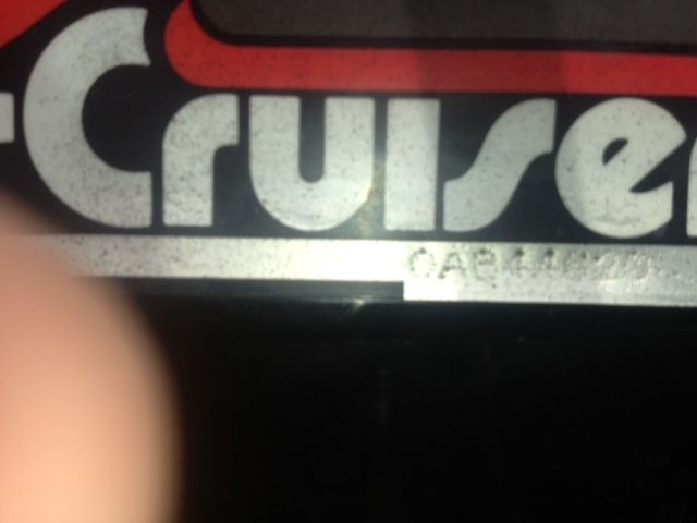

fordmugg
Apr 29, 2008
133
Re: need help!!!!!!!!!!
This is what I have on there
achris
More fish than mountain goat
May 19, 2004
27,468
And this is what I get when I put that number in....
attachment.php
I have also tried every combination of numbers that look like they might be something else. Like substituting 3, 9, 0, 8 and 6 for the 8, 6 and 0... Nothing comes up a drive.
Is the drive an original or maybe a re-manufactured unit?
Chris....

achris
May 19, 2004
27,468
It's a reman, that's why you don't see it Chris, go HERE and try it.
Sneeky... Thanks Don.... Would be nice if posters actually mentioned these things :D, but I guess that would take the fun out of life... :facepalm:
