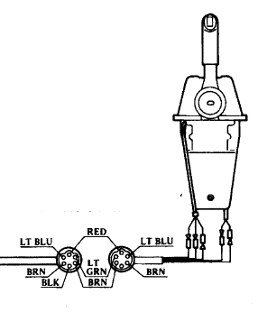

I know what the pin colors are and what they go to. But i dont want to cut wires and put pins on if there is a sub-harness that simply snaps into place. My 704 control box has the wires shown above. Is there aYamaha harness that the pins on the ends of the wires go into that then allow those wires to connect to.....

Who brought up pin colors and what they go to?
Are you not seeing the five wires with bullet connectors on them that connect to the bullet connectors on the 704 control box? That make up a harness that will plug and play with the 704 ten pin harness?

I am thinking he is looking for the part that connects to the 10 pin (or six pin according to pic) harness that has the bullet connections on the wires that plug into the ones on the 704

I looked at the diagram you posted above and thought you were providing me with the wiring colors. I have been pulling my hair out tfying to get the main electrical working and it seems like I am just missing one link to get it done. Now i've been told I also will need a wiring harness that goes from the engine to my console for the trim. This part is killing me! So, i do not have the harness you show above that my bullet connectors go into and then terminates in a round connector.

The wires for the trim are in the ten pin harness. The harness that connects to the 704 remote control box at one end and to the motor at the other end.

YES!!!! That's it! Thank you very much! I just ordered it. That should solve all the problems of the world....or at least my current problem.
