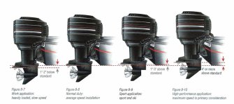

4. When I bought the boat(82 Ranger 330V), the motor was mounted all the way down on the transom. Two years ago I moved the motor up from the transom to the next adjustment hole. I'm not sure what the proper height should be but I felt that the motor sat to low in the water, especially when I had a full fuel tank. The tank is, unfortunately, mounted all the way to the back of the stern. Later model years have tanks mounted beneath the seats. I'm sure that makes for better load distribution.
5. The motor is trimmed all the way down at WOT
Also, I did remove the hydrofoil fins. I'm not sure if that had anything to do with it or not, but I topped out at 45mph last time out
#4
#5
Trimmed all the way Down at WOT? That is one way to really kill Top Speed, and create a very Dangerous Control Situation.
Trimming all the way Down is done to reduce Bow Lift getting on Plane and running at very low Planing Speeds. Usually once on Plane, the engine is Trimmed out, until Porposing happens, then trimmed back in/down until it ceases. As speed goes up, the Engine can often be trimmed further out
