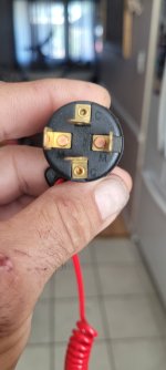

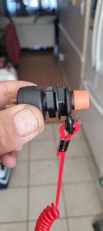

I took the boat to the lake and it wasn't pretty. I managed to adjust one of the engines idle and everything. The second one would not hold idle in gear.
I have to mention I removed the kill switches on both on was not working at all.
I bought 2 new ones and want to make sure I put them on right.
In tye picture you'll see 4 connectors the M has continuity when the lanyard is attached. I have no clue what the right way is. All I know is without the switches I get ground at the engine on one motor and nothing on the other.
I drove the boat at higher speed and the motors were better together my rom went to 4200 at wot could be more I did not adjust the tachs. But as soon as I would put it in neutral bot engines died. Would have to start and imediatley go in gear. It was a pain.
Let me know please on the lenyards. I have to reopen and clean the carbs. The filters were full of sand before I changed them and one might have leaked. I will also have to repairthe trigger wires as 2 were broken for number one and I repaired them already. Thanks

Lanyard should have open circuit when attached.
When removed there should be a short circuit at lanyard.
To stop the engine you ground out the black/yellow (stop wire) wire.

Ok so the M in the picture has continuity with laynard attached. I should use the other 2 connectors right. Also I have ground without these kill switches connected so black and white wire at the dash disconnected. I have to check why I get ground and why the engine starts. The other engine also starts and stops with ignition and no kill attached and no ground at the purple or white wire at the junction. F..k

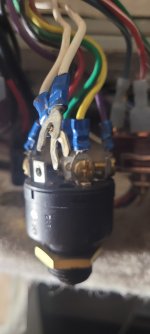

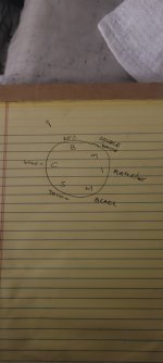

Ok so the white wire that has the ground which goes to the junction box and connects to 2 black/yellows was connected to the ignition switch M see 1st picture. I am including the ignition switch diagram I wrote picture 2.
The other ignition switch fell apart when I touched it so I have to replace it. That one also had the 2 white wires connected to M on the switch but somehow they were not grounded at the switch. I am trying to figure out why M has ground or if that is ok why the white wires are connected there. It is like a bypass to always have ground. So the 2 white wires for each switch are one from the kill switch and the other to the engine at the junction near the starter connecting to the 2 black/ yellows.
The ignition switch that is still good is like in the picture and the 2 M connectors are shorted or there is continuity between them. That's why I had ground at one engine white wire even though the kill switch was not connected. I don't know why that engine even started but it did and ran great.
So I am looking for an ignition switch now..

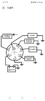

This is a diagram that I found it looks pretty close to my ignition except the blue wire that goes to M is black on mine.
Check where/what your black wire goes/does, to verify if your black is functioning as blue would

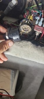

Ok got the new ignition switches and I tested them with a meter. So when the key is off there is continuity between the two M connectors on the switch. As soon as you turn the key the circuit opens and the kill switch becomes the one that controls the
continuity. So I have to check if the switch I still have on operates that way. It might not open the connection between the 2 M connectors. So that's how the kill switch operates. That's why you turn off the motor from the switch even if the kill switches are not on and the engine runs. The white wire gets ground and shut's off the engine. And probably the power gets disconnected also. At least I think that's how it works. Now I should have no ground to the wire at the engine with the key on.
I also fixed every small wire at the junction where the trigger wires go. I did find at least 3 that were either broken or broke off right away. Most were ok but I redid them anyways.
