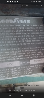

J Jwoods Recruit Joined May 9, 2023 Messages 4 May 9, 2023 #3 Need a lil help on what year motor this is or where i can order a set of points at for it. Thanks. Model # 2G2 Serial # 89583

F F_R Supreme Mariner Joined Jul 7, 2006 Messages 28,226 May 9, 2023 #8 Model 2G2. 1947. Breaker points 580016, condenser 300153.
