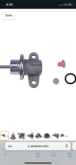

Hey didn’t see a color ring
Can you send me the link to the one I need
Chrisw87
Jun 12, 2023
48
I understand it takes a 30 psi fuel regulator that sets on top of the cool fuel system. Does anyone have a part number for this I can’t find it

Sorry didn't realize you posted requesting the part number. I merged the threads to keep them together
Part number is 807952A1
That said I'm using 1999 to 2001 TBI because I don't have your serial number. Might have missed it

Looked back at the regulator that I ordered and it’s the same part number you gave me. Could anything else cause it to have high fuel pressure
alldodge
Mar 8, 2009
43,923
The Reg screen, but you said it's new and came with new Reg
Partial collapsed fuel return line
There is a Reg in the TB but that should have no effect on pressure because if Reg releases any pressure it has no place to go. Most TB Reg's are just to dampen fuel pump pulses
Only other thing is if your gauge is off
You can bench test the new Reg
