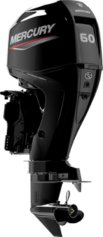

The following pics corresponds to your current Lowe's boat and Merc motor right ?
